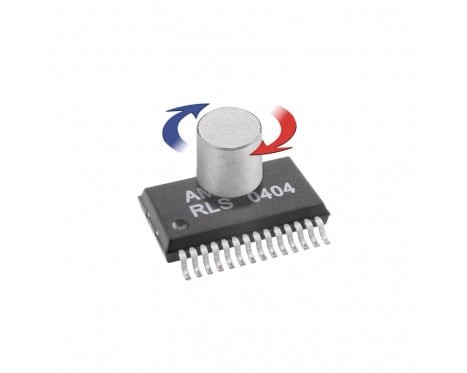

IIRC they use roughly the same method to determine their position. While the NEO is only 50 cpr, the falcon uses the same idea of a bunch of tiny hall efect sensors in a ring on the chip to read the flux density distrabution of a diametrically polarized magnet across the ICs surface. Only difference is the falcon has a higher resolution chip, similar to what youd find in a SRX mag encoder or cancoder. Its literely just a single chip so this is the closest I coud find to a diagram.

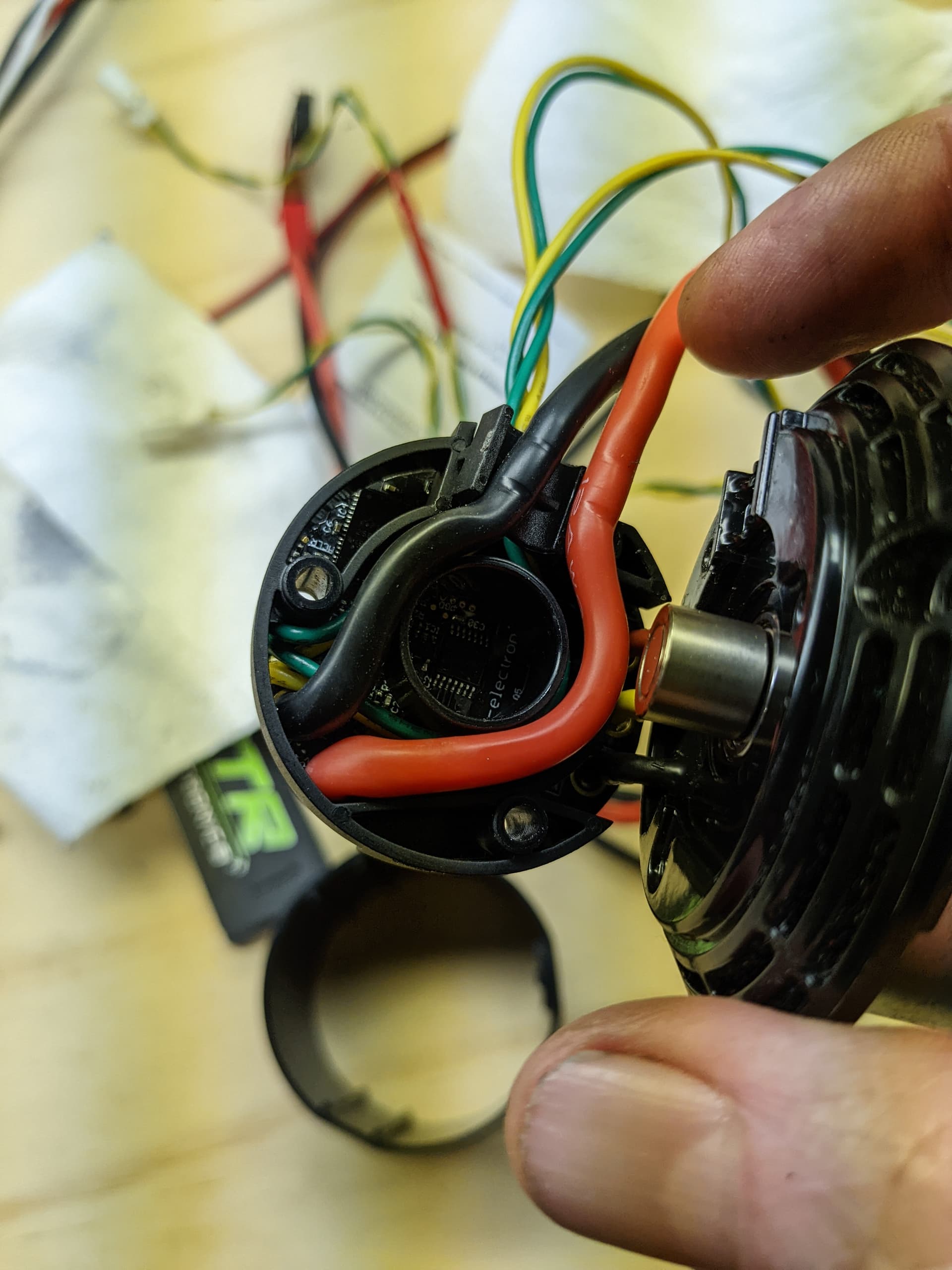

The magnetic is on top of the shaft. The transducer is on the controller bolted to the motor. The software required to align it is not publicly available. This one is officially broken.
