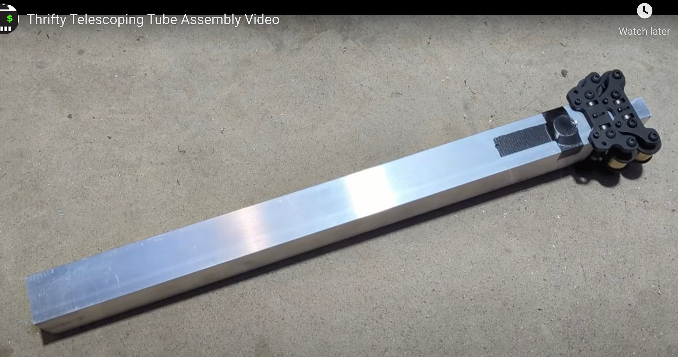

How does this Thrifty telescoping arm connect to a motor?
You need to add a bracket for the winch/motor. The AndyMark climber is a good example of a solution
Are you asking about using a motor to extend the tubes, or how to retract them?
Retracting
This is intended to be retracted using a winch system. You would attach one end of a string to the innermost stage (how exactly you do this is your choice), the string goes down through the tubes, and the other end of the string would be attached to a spool at the bottom of the system. The string needs to be as long as the telescope when its fully extended. When you want to retract, you rotate the spool, and the string pulls the inner stage down.
Extension
This is not really designed for a motor to extend the tube - that is what the constant force springs are for. One way to extend is by holding the inner stage “down” until you want it to extend, and when you remove that hold down, the springs will coil up and it will extend itself.
Alternatively, you could extend the system by starting the match with your winch string fully spooled, and run your motor backwards to extend it. You still need the constant force springs here because you can’t push a rope.
With a couple of bearing plates, you could just mount the motor to the bottom 1" or so of the tube, building a winch spool inside the tube, similar to how chain-in-tube drive trains work. Or you could put it a bit below the tube, using (for example; AM and Vex also have solutions) one TTB mega motor plate and one TTB mega bearing plate, a spool, and your favorite gearmotor configuration with a shaft a bit over 2" long, and a bearing for that shaft.

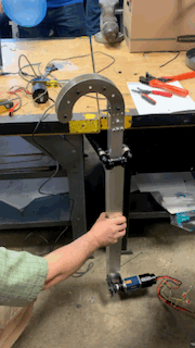

Added: just like @Ryan_Dognaux 's second image :point_down: , except for the off-center bit.

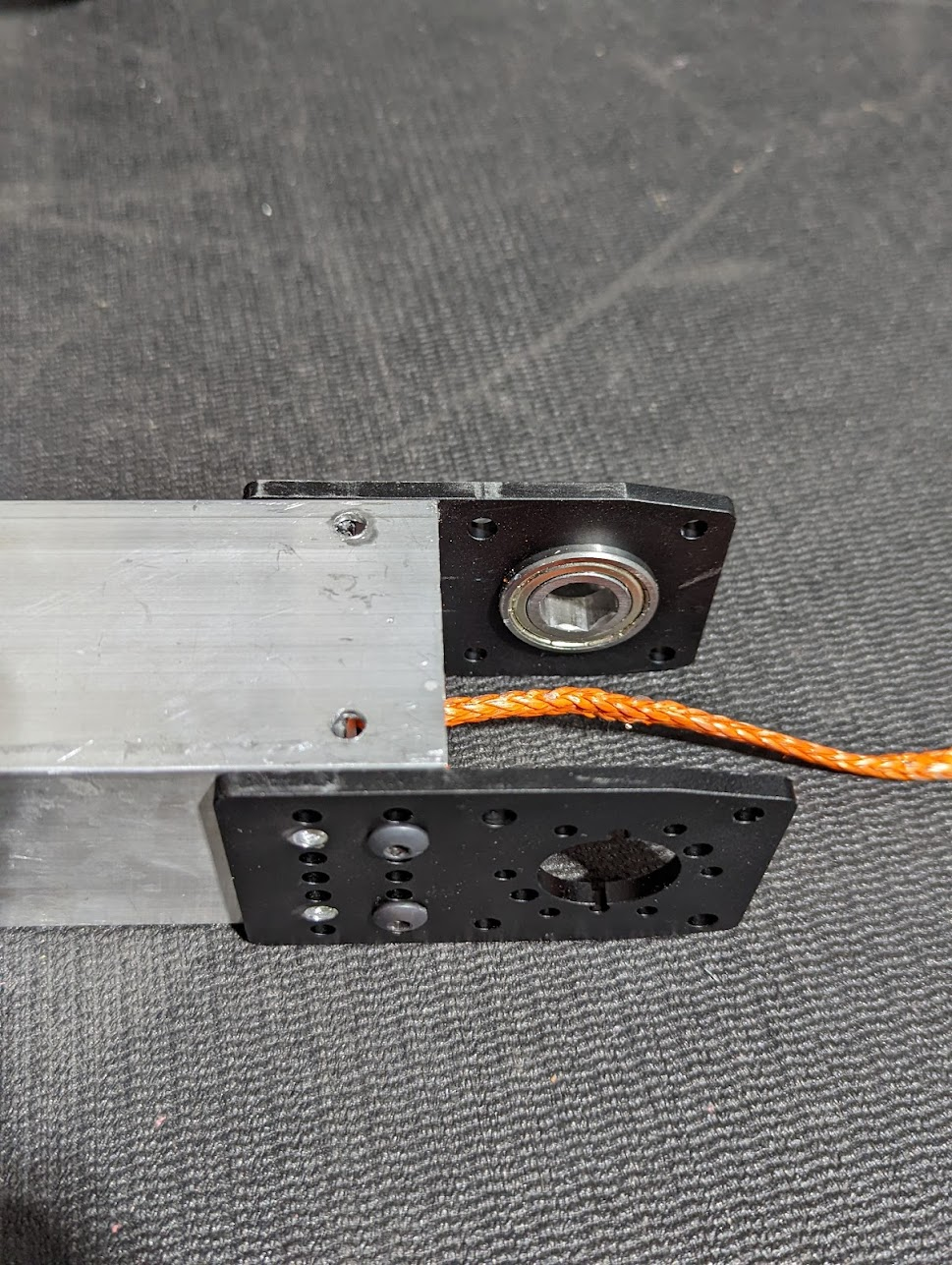

We just have ours a test drive today- Took some inspiration from the way the AndyMark attaches their motor and path for the rope.
Thrifty Mega Motor plate attached to the side of the 2” tube with a Falcon Sport Gear box- (purchase the 3” long shaft to make this easier) make a spool from 2 Thrifty Hubs and press then into a 1.5 long piece of 1.124 ID Aluminum tube- then on other side Thrifty Bearing plate-
We installed a 1/2” rod inside the tube to allow the rope to make the 90 turn through a 1.125 hole and finally on to the spool.

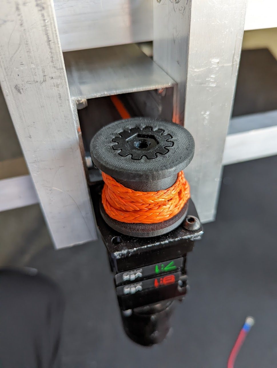

For the video test setup, I just ran a versaplanetary mounted directly under the tube with my motor / bearing plates with a drum to wind the cable and a 3D printed hook that was physically bolted into the top stage. The dyneema cable was fed and tied off on the hook so when pulled down it retracts the stages and when released the stages extend.
Here are a few pictures that I took that sort of show the setup, didn’t get a picture of everything altogether.

Thanks for your response! Does the drum come within the telescoping arm kit? If not, where can we purchase it?
Also, what is missing from the setup in the first photo? I infer that the following are missing: a thrifty bearing plate, a bearing, and bolts, but I’m not sure how the drum would connect to these components since the hex shaft doesn’t protrude the drum.
I was going to leave this one to @Ryan_Dognaux, but doesn’t seem to be typing, The spool pictured appears to be one of his thrifty inserts in a 3d printed plastic spool.
If you don’t have 3d printing, a serviceable spool can be made from two hubs (pick your manufacturer) with the extensions facing each other (that is, flanges away from each other), and spacers or shaft collars holding them together. Use any of the holes usually used to mount a wheel as your rope anchor point ( you may have to drill it out a bit).
The hubs have a 1.125 diameter circle hub around the hex in the center- you find a piece of 1.12 inner diameter tube- cut it to about 1.5 inches and press a hub into each end. It make for a nice tight press fit.
Yes you will want a bearing fir the plate to help support the axle the “drum” will be on.
The 1/2” rod is just a piece of aluminum rod that we cut to length to fit inside the 2” tube to help with the rope making the 90 degree turn outside the tube. Honestly look at the AndyMark documentation on how they do this set up for their climber. It is better then anything I can provide.
