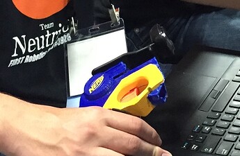

In 2019, one of the kids on our team rigged up a QR code scanner using a Nerf gun and a webcam. :sunglasses: Last year, we realized we could just buy a USB bar code scanner from Amazon for like $20, so we have that now. :sweat_smile:
