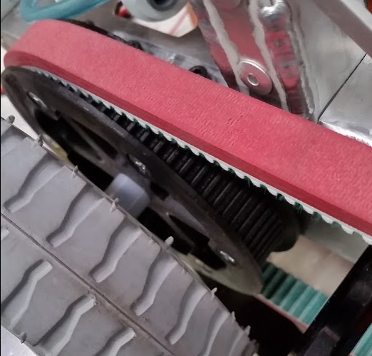

Does the red make the swiss cheesed one go faster?

No, but stickers add five horsepower as always.

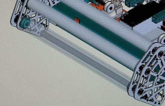

People often design intakes with large rollers on them or lots of different wheels, with a giant hex shaft going through the middle. You often don’t need that shaft. Try to replace smaller wheels with a more lightweight roller supported on both sides and either a dead axle system, or a way to get rid of the middle unused portion of the hex shaft.
You can see inside the bottom transparent roller that the hex shaft driving the roller extended from the 3D printed tube insert to the bearing on the far side of the plate, retained on both sides by snap rings.
