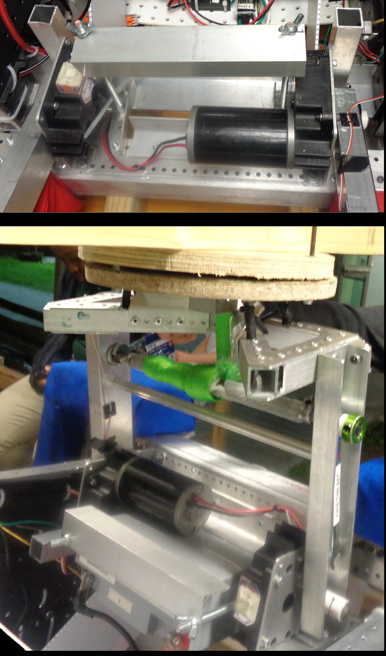

Edit: attached photos of our 2016 battery holder, taken the night we bagged. Top image is overhead view with battery removed; the battery sits in the 2" x 1/8" angle which mounts our winch, and is held in place at the base with three more aluminum angles, and is held in at the top with another angle. At the bottom is a picture with the battery in place, as we completed a test climb outside our shop; up is really up, and the battery is now horizontal.

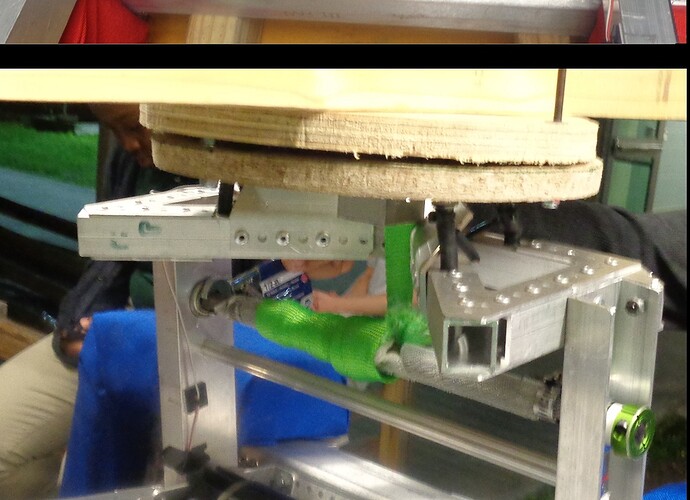

We’ve used the same bent sheet metal battery box part in the last four or so robots. It’s a bent 0.125 50something sheet about four inches tall. It sits vertically against our bellypan, then a velcro strap over the top. We’ve never lost a battery.
You can see it in the top centerish of this picture:
