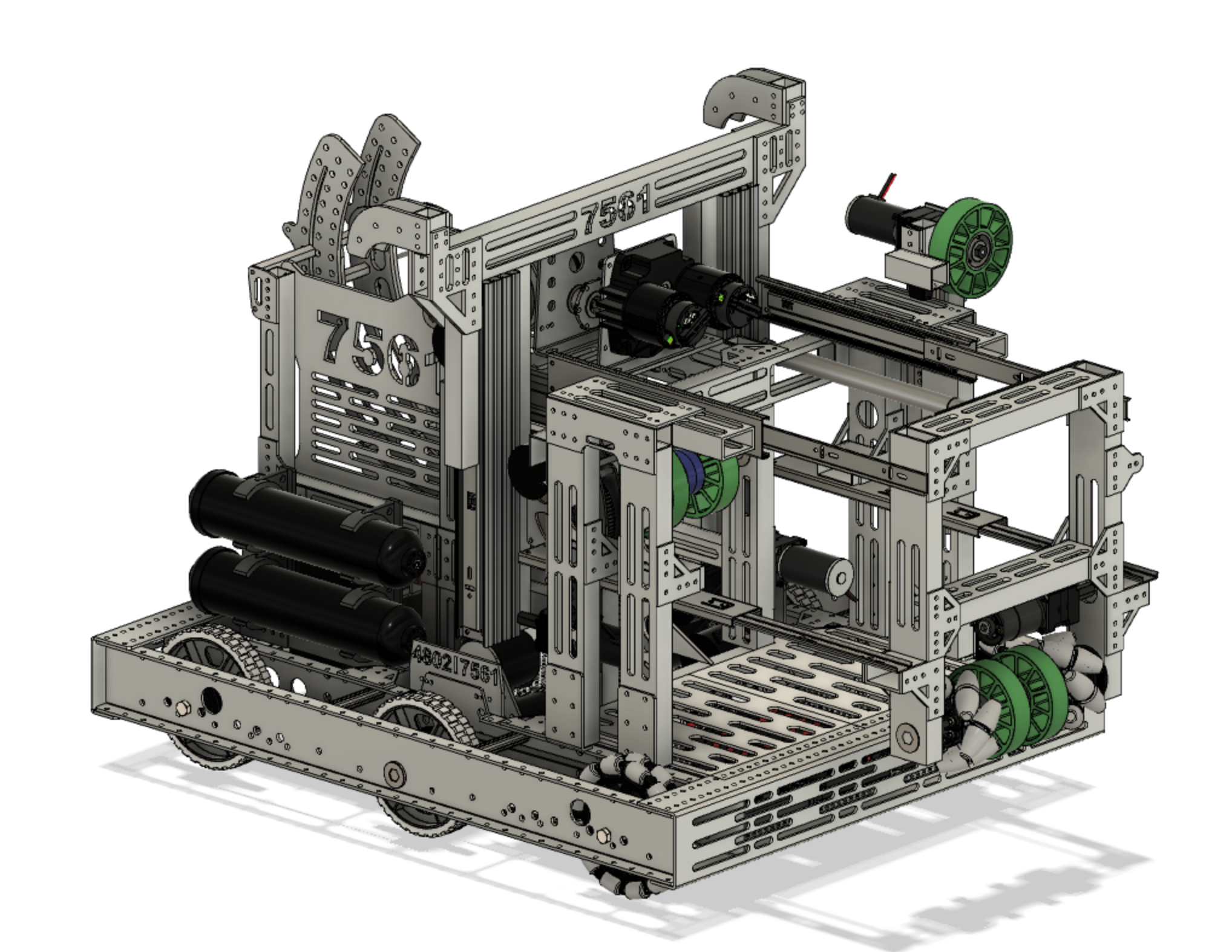

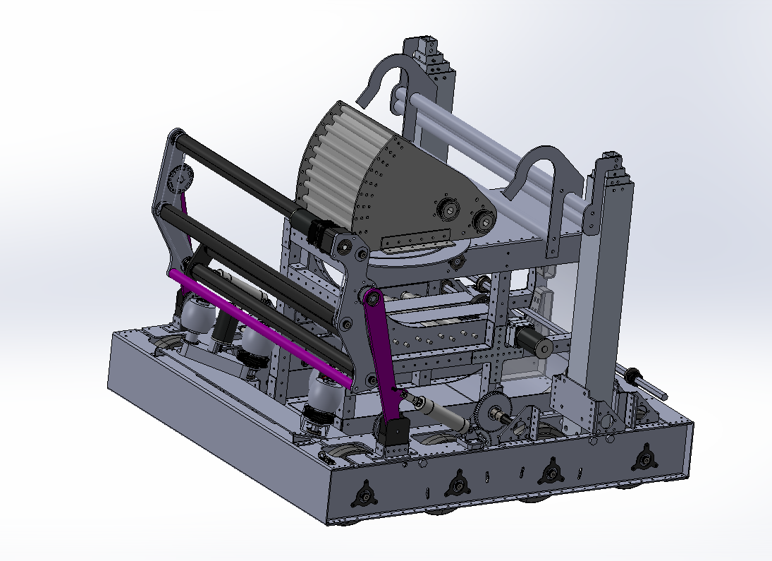

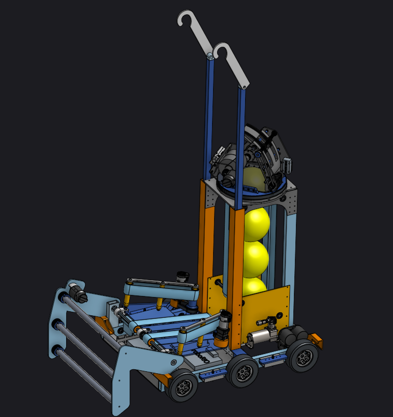

Hi CD. My team is planning to climb in the center of the rung and allow other robots to hook onto a buddy bar on our frame. I’ve seen a few robot designs that use two widely-spaced hooks (here, here, here, & here). For buddy bar design purposes, about how far apart will your hooks be?
