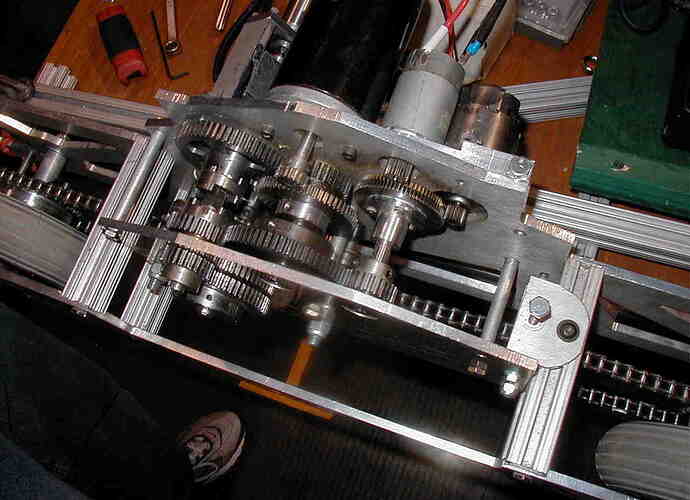

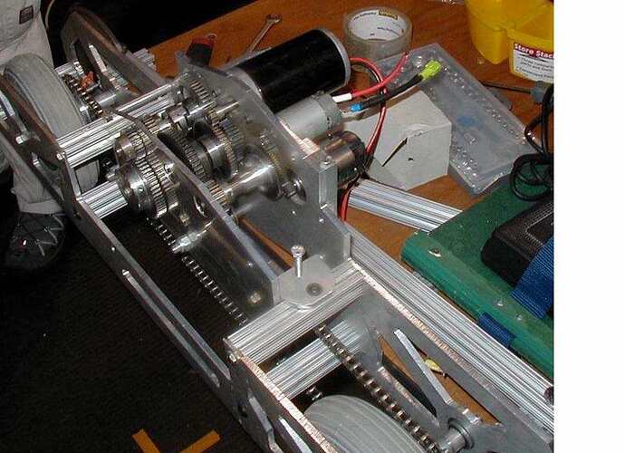

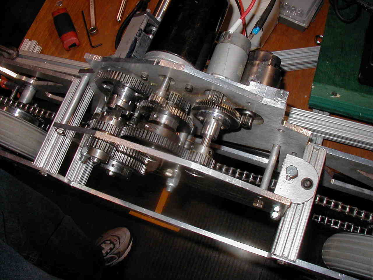

there was one team at Manchester that used 4 motors per side. Due to the fact that I am in school at the moment, I can not post the picture I took. I will post as soon as I get home
ok here is that pic. I was wrong, they used three. I will have to give credit to team 229. It is their gearbox.

Here’s a link to the write-up on 188’s gearboxes. 3 motors per side, 2 ratios, chain-driven skid steering. (This is the 3rd year in a row in which 188 has used six drive motors.)
