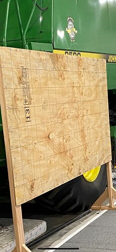

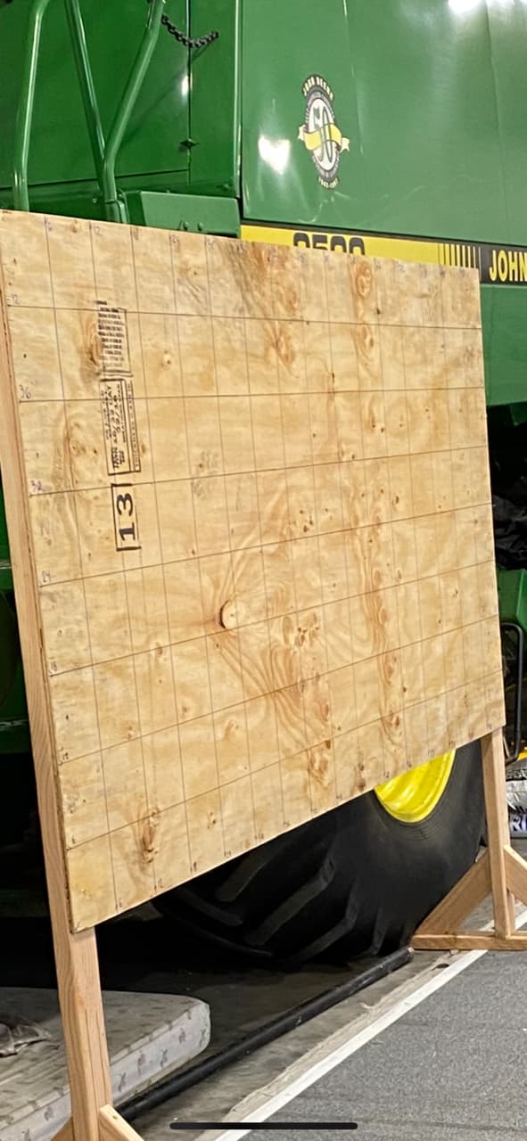

100% Concur. Use math to get close and then test. We put our shooters in front of this board with a 6" grid and then filmed them in slow-mo at various motor velocities to get precise measurements of exit angle and velocity (and if you put a stripe on the ball, a decent look at the amount of backspin).
