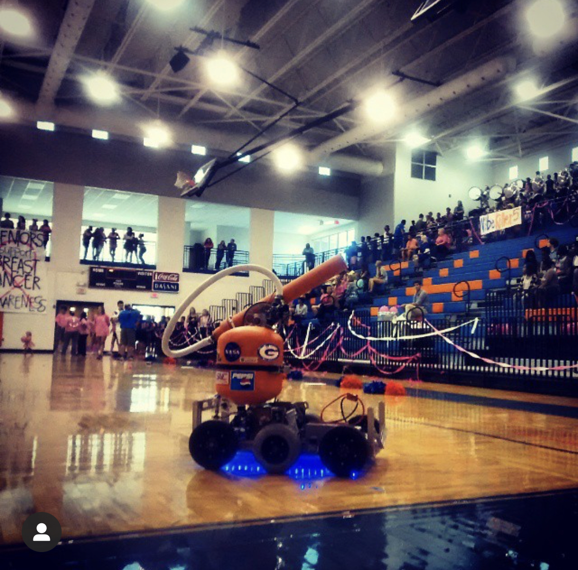

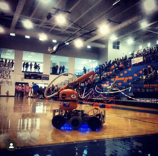

We used to fire t-shirts at pep rallies with our t-shirt shooting robot. It had six 6-inch (or 8-inch? Can’t tell) pneumatic tires, and we never had any problems scuffing up the gym floor. Just drive carefully and don’t drift the bot and you should be completely fine. Here’s a pic:
