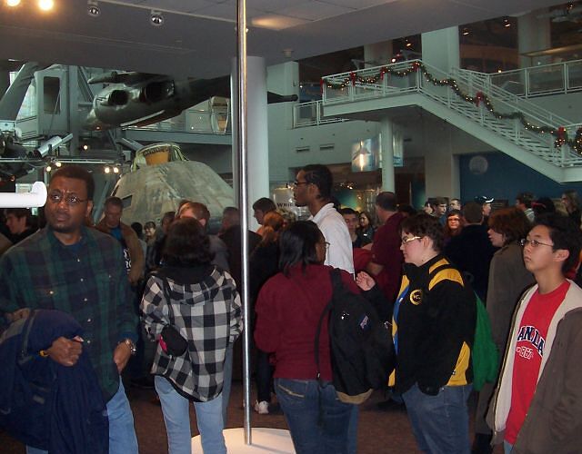

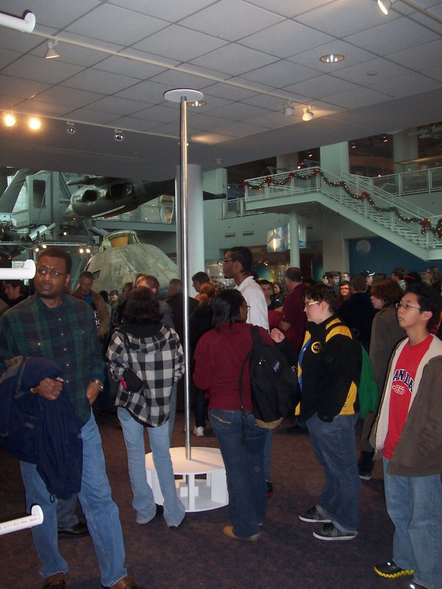

This is Mr Mummert from 1610 in franklin…this is the one from the Hampton
Kickoff.
