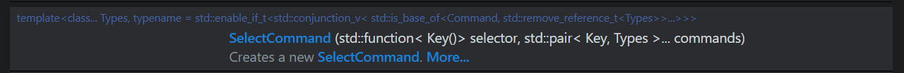

In particular, the documentation indicates that there is no default (that is, no argument) constructor, which is the cause of the error message you are seeing.

Perhaps we should remove the magic SFINAE constructor, though, because i don’t think anyone who isn’t a C++ wizard will have any idea what it’s doing.
SFINAE constructor?
To use this, you have to understand the template expression, which only expands properly in some contexts and otherwise is ignored (this is called “Substitution Failure Is Not an Error”, or “SFINAE”). It also contains a fold expression…
What would you replace it with?

The std::vector<std::pair<Key, CommandPtr>> constructor should be fine. There’s no need to do fancy fold expression sugaring here; it saves a single pair of brackets at the cost of requiring the user to know high-powered template magic to know what it even is.
