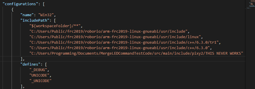

I have tried many variations of adding directories to c_cpp_properties.json and NONE work. Compilation still can’t find the include dir.
“configurations”: [
“name”: “Win32”,
“includePath”: [
“${workspaceFolder}/**”,
“C:/Users/Programming/Documents/MergeLEDCommandTestCode/src/pixy2/src/common/inc”,
“${workspaceRoot}/src/pixy2/src/common/inc”,
“src/pixy2/src/common/inc”,
“C:/Users/Public/frc2019/roborio/arm-frc2019-linux-gnueabi/usr/include”,
“C:/Users/Public/frc2019/roborio/arm-frc2019-linux-gnueabi/usr/include/linux”,
“C:/Users/Programming/Documents/MergeLEDCommandTestCode/src/pixy2/src/host/windows”

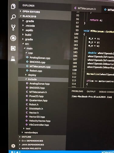

If I understand your question properly, you have created a class in a header(h/hpp) and source (cpp) and are confused how to use them in your robot class?
As you can see in my pic, put your cpp in src/main/cpp and header file in src/main/include.
Then you just #include your header file in the robot.h or other file as appropriate.
Your code should be in src/main/cpp and src/main/include, but you can change these paths my modifying those entries in your build.gradle

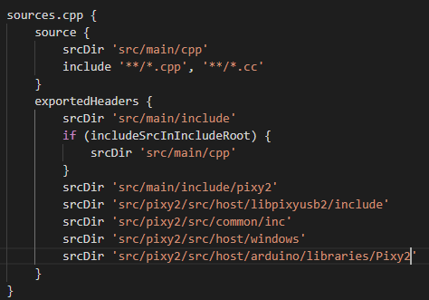

(2) We used intellisense to add the linux directories for the base C++ dependencies like stddef.h. Hover over the lightbulb, select add to the properties file. VS put these into the c_cpp_properties.json file. HOWEVER, our attempts at adding the pixy2 include directories manually to this json file did not work, a painful lesson.
(3) As Jaci suggested, we found that adding the pixy2 include directories to build.gradle got them into the system build. Many hours needed to figure this out!! Now we can keep the pixy2 directory structure from git as-is, a big win.
