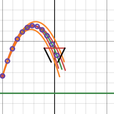

we used this to calculate the needed info.

Note that a range of speeds and angles can be found to make shots from a given distance. You can tune for “flat” shots or high-arcing shots. We attempted to find the set of speeds and angles that resulted in roughly the same maximum height the cargo reached in its trajectory from the complete set of distances. We liked the robustness and cargo bounce action inside the hub cone with trajectory apex heights of about 12 feet.
Also, be wary about using parabolic trajectory simulations to build your interpolation table or curve. The fuzzy cargo trajectory is strongly affected by spin rate, which can be hard to model accurately. If your cargo has any appreciable spin, empirically-determined data will be your friend.

Mechanical guy here, I know we tune shoots at various distances, but no idea how it works in the software. What I do know as an ME, is that parabolic trajectories rely on negligible air resistance, and predictable exit speeds and angles. Trouble is, air resistance and spin often isn’t negligible, and shot speed and angle is hard to measure even if your shooter is very consistent.
The physics calculations can be good for figuring an approximate range of speeds and hood positions to design for and start your tuning from, but building a sufficiently accurate model to predict shot trajectory is insanely difficult and unnecessarily for FRC. Tune shots, use the empirical data.
