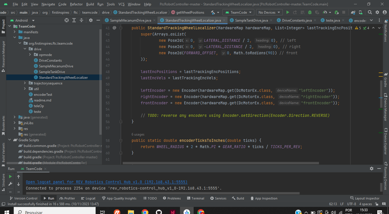

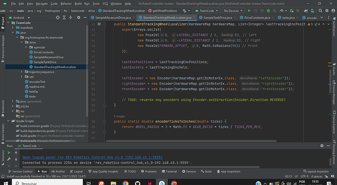

Why does learn ROAD RUNNER have these lines then?
You are supposed to change those to correspond with what ports the odometry pods are plugged into. As in, if leftEncoder is plugged into a port with a motor named “MyMotor”, that line should be
leftEncoder = new Encoder(hardwareMap.get(DcMotorEx.class, "MyMotor"));
