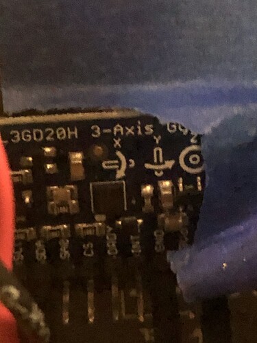

Hello, we need lots of help we get an error of gyro not found in SPI port. The gyro is the one shown in the picture and we connect it to I2C but in the code we use ADXRS450 gyro. Thanks!
what happened to this gyro it looks damaged . did somebody step on it or something ?
Call me crazy but the gyro in this picture doesn’t even look like the one you say your using. I could be completely wrong as I cant see the whole board.
