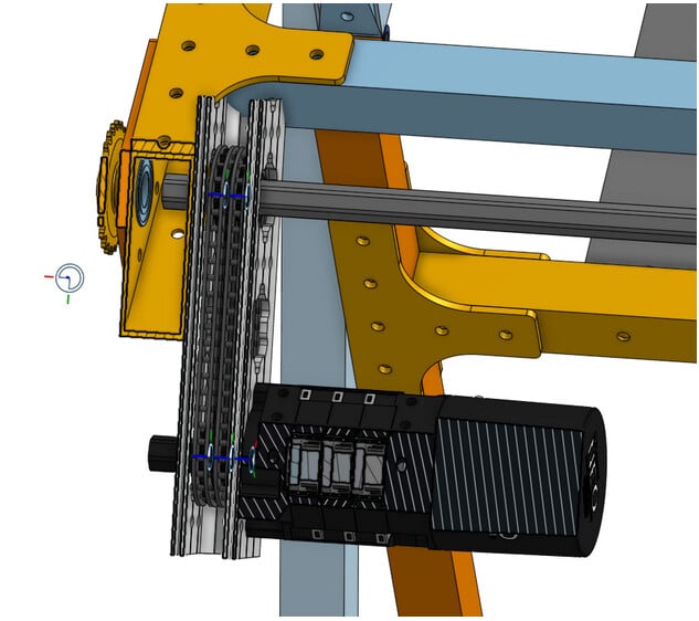

You could also achieve “custom COTS” gearboxes using the MAXTube pattern/Ratio Plates but that is bulkier.
Onshape Link
(The Idea would be to have different-sized gears/sprockets for more gear reductions along MAXTube. Photo shows a 1:1 after the MAXPlanetary reduction)
