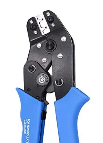

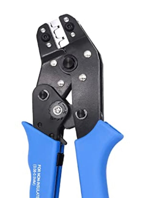

You need a wire crimp tool. They look like this:
You will probably be able to find one tool to crimp both types of connectors. I am not confident enough to recommend a specific tool.
This video is a decent demonstration on how to use the crimper tool.

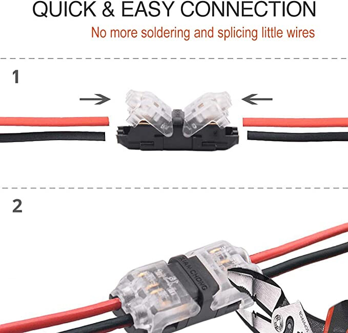

You don’t have to use those connectors to join CAN wires if you don’t want to. Here are some options that don’t need any crimps at all:
https://www.amazon.com/Low-Voltage-Electronic-connectors-Solderless/dp/B072P15279/ref=sr_1_4?crid=6IJMHKVY7YOO
Our team uses these.

you dont. get some wago connectors and thank me later

Have used these 2 years in a row now. Absolutely love them. We had a single instance where we had a CAN fault on our network this year. Found a connector that seemingly had an intermittent connection when moved, even after reseating the wire in it. Threw that connector out and replaced with a new one.
I consider a single faulty connector (well, potentially faulty) is a pretty good track record over the sample size of about 100 connectors used these last 2 years.
