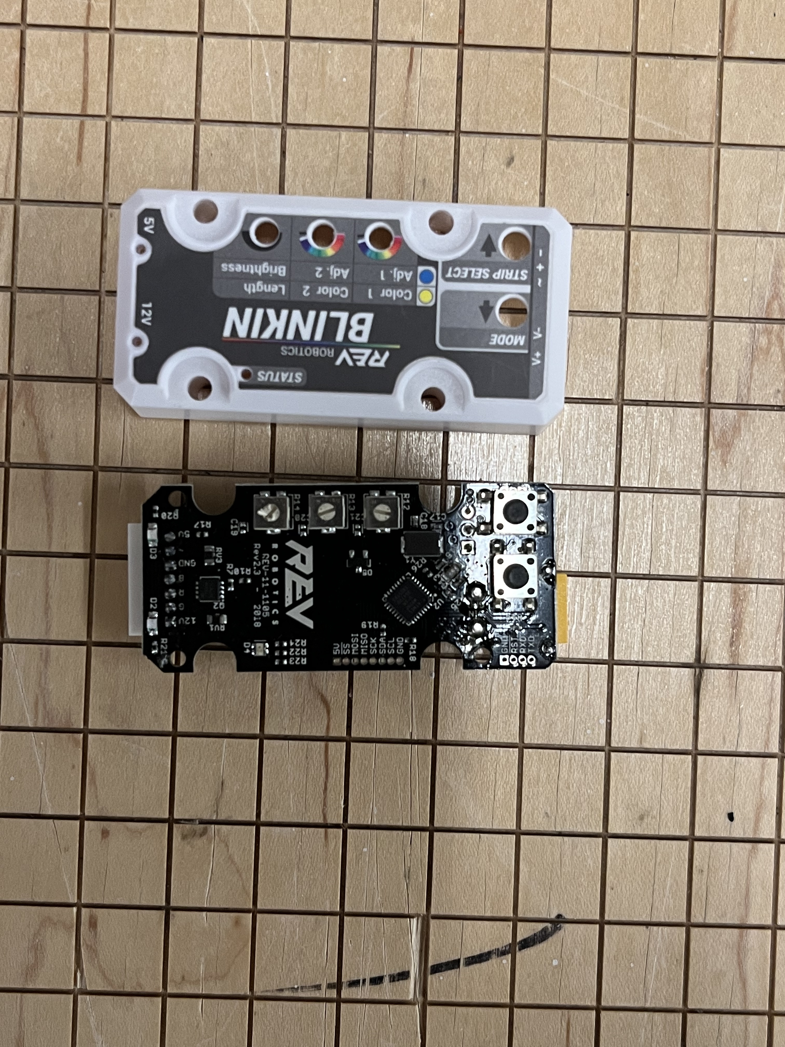

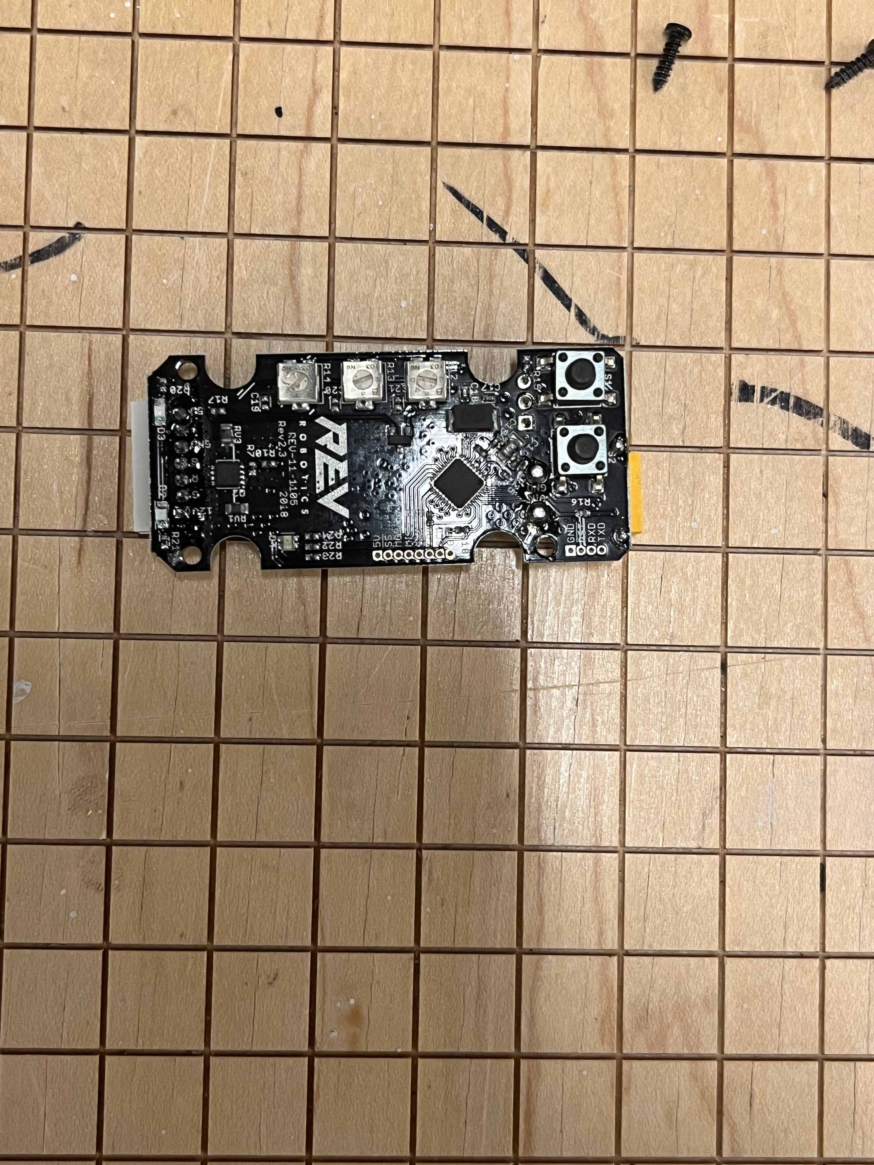

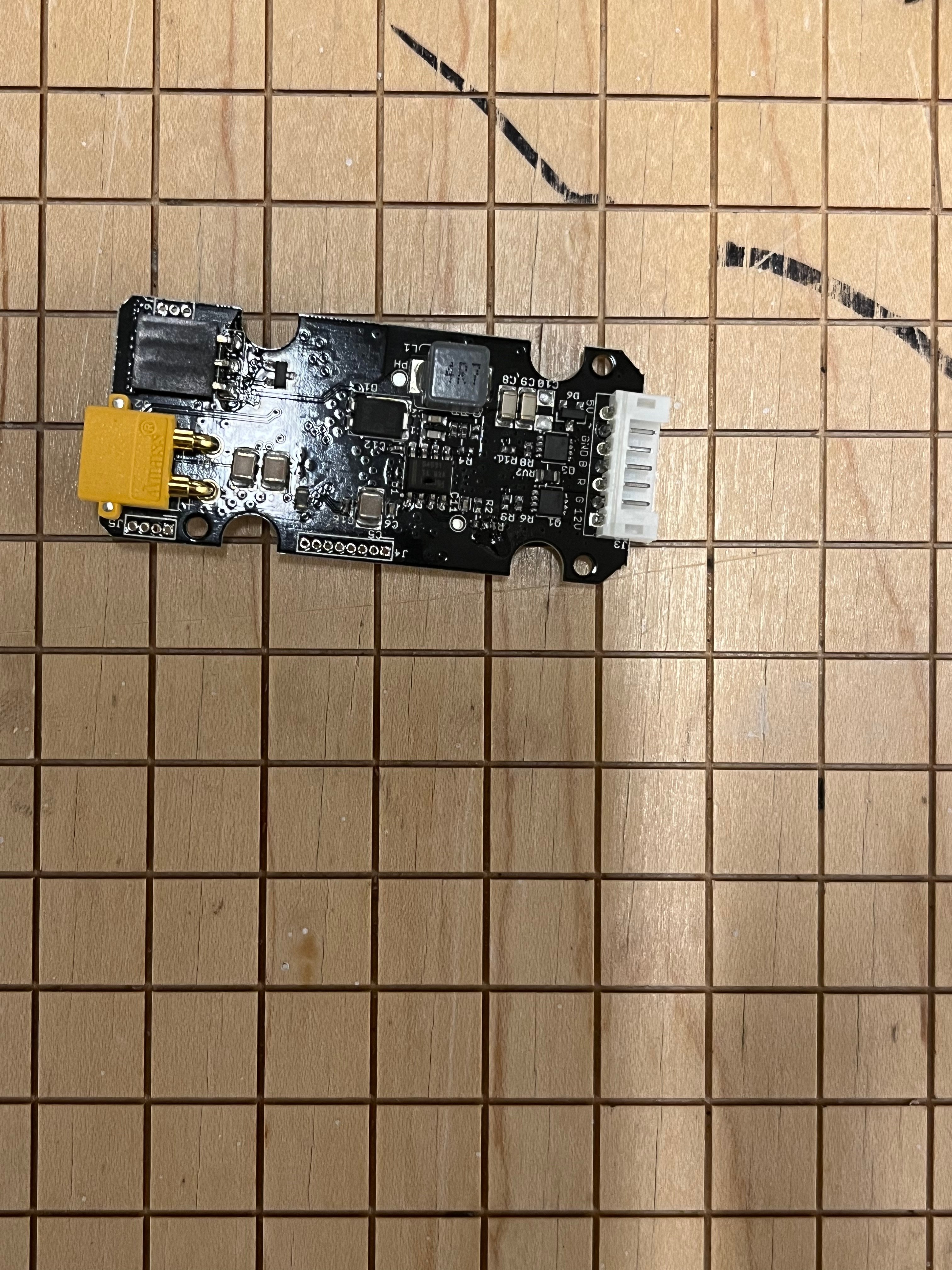

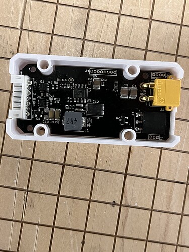

I am currently with the driver — both sides of the board
LEDs can typically handle reverse voltage (but still worth trying). :slight_smile:
I don’t see anything visible, but it’s likely that at least one of the components is damaged internally.
Contact REV and ask if the Blinkin is typically permanently damaged by reverse voltage.
Based on past experience, if the “pop” was not very loud, it is likely that the damage will not be visible.

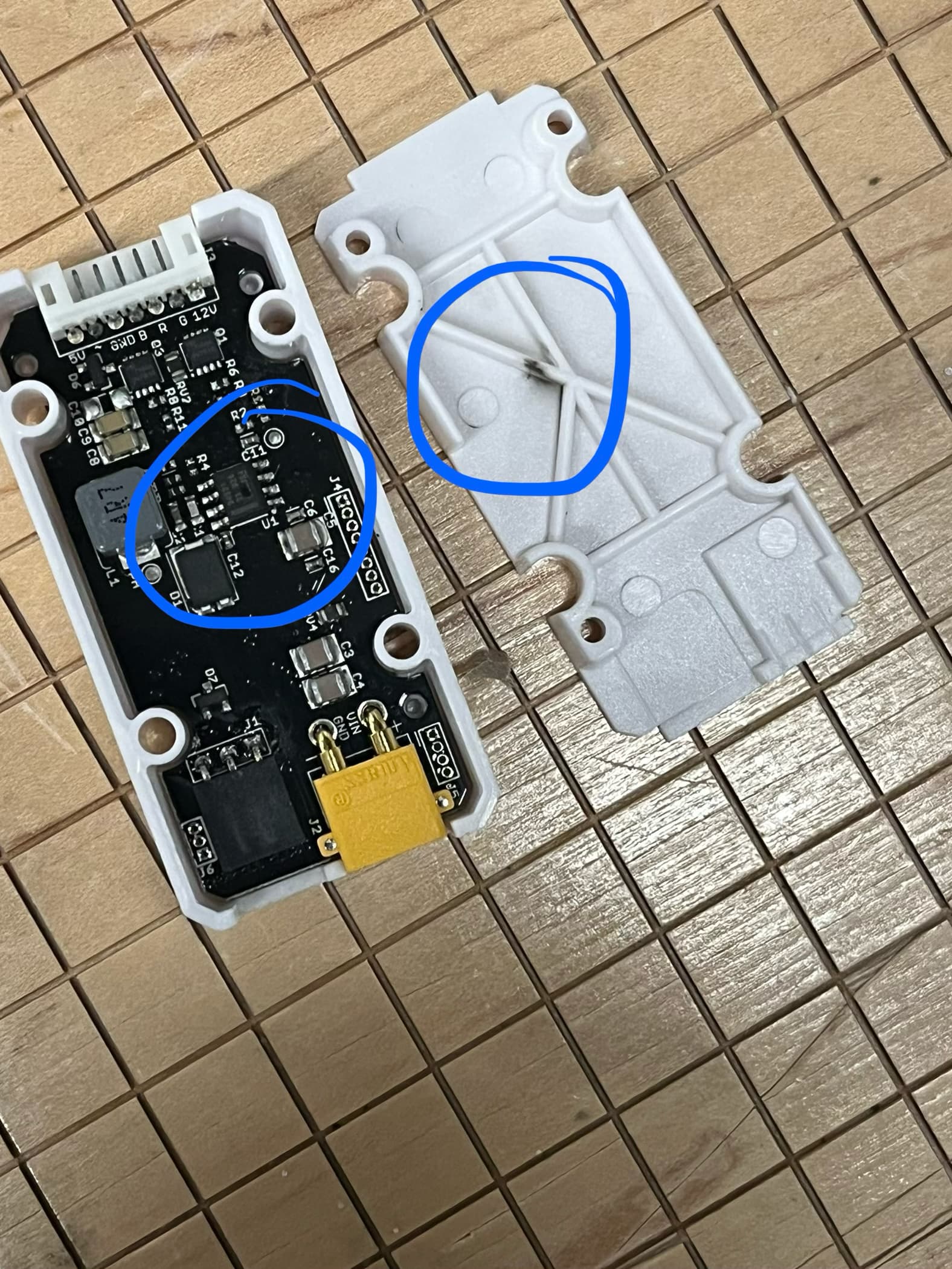

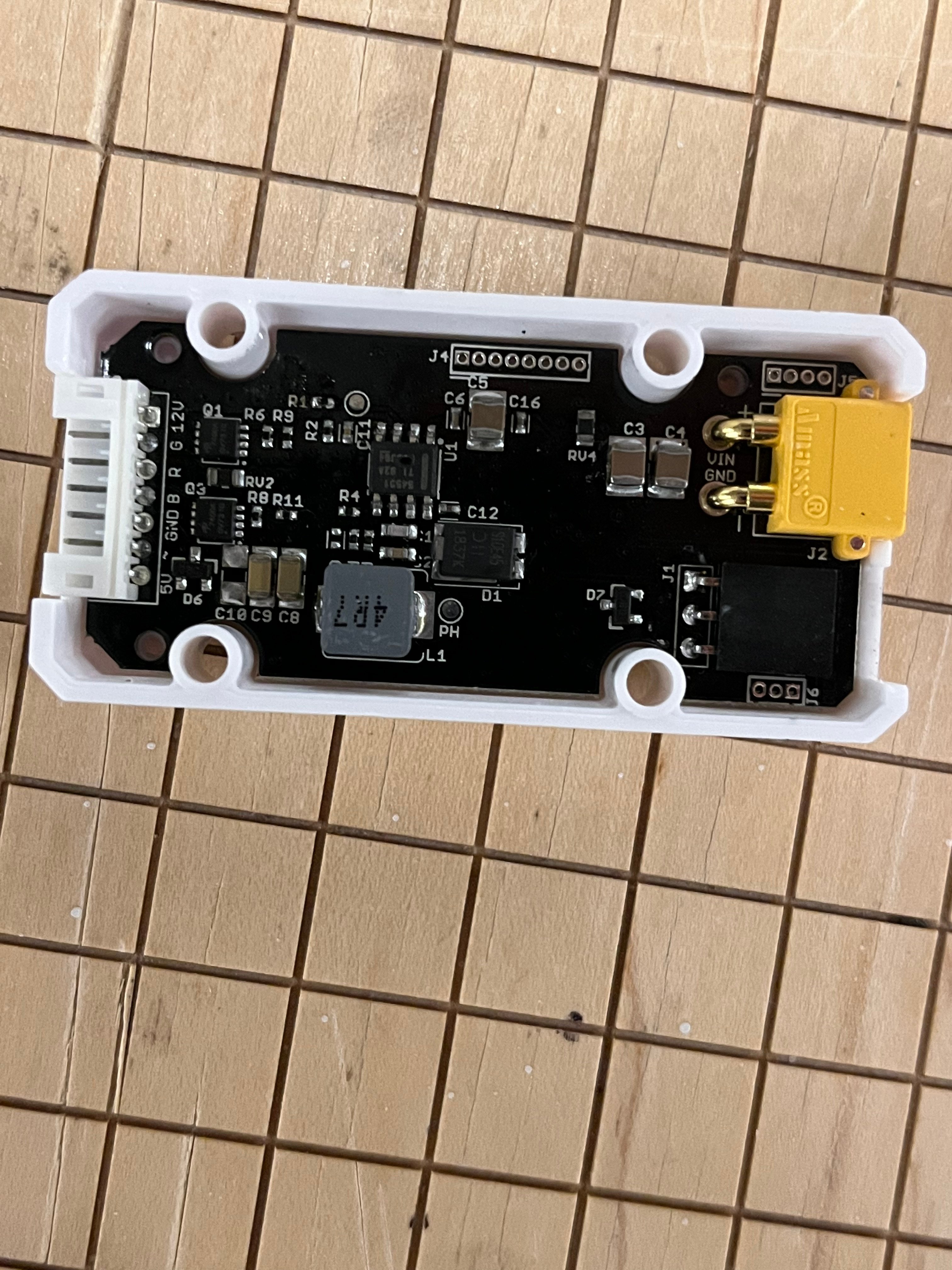

Alright. I took another look at the driver and I think I found something, this dark gray box seems to have a hole in it and the back panel on the same side has a gray mark aligning with it. I’m not sure what the object is for or what it would be reparable with, though.
It says “5431 T 5 9 2 A”
It’s likely this (or a similar) part: https://www.ti.com/lit/ds/symlink/tps5430.pdf. This would typically be used to take the 12V power input and convert it to 5V.
It’s not repairable, and replacing it would be tricky (and not guaranteed to make things work again).
Yes. It looks like the “magic smoke” that makes the chip work has escaped through the hole in it so it can no longer function.
Unfortunately, only the original manufacturer has the equipment necessary to insert the magic smoke :wink:
