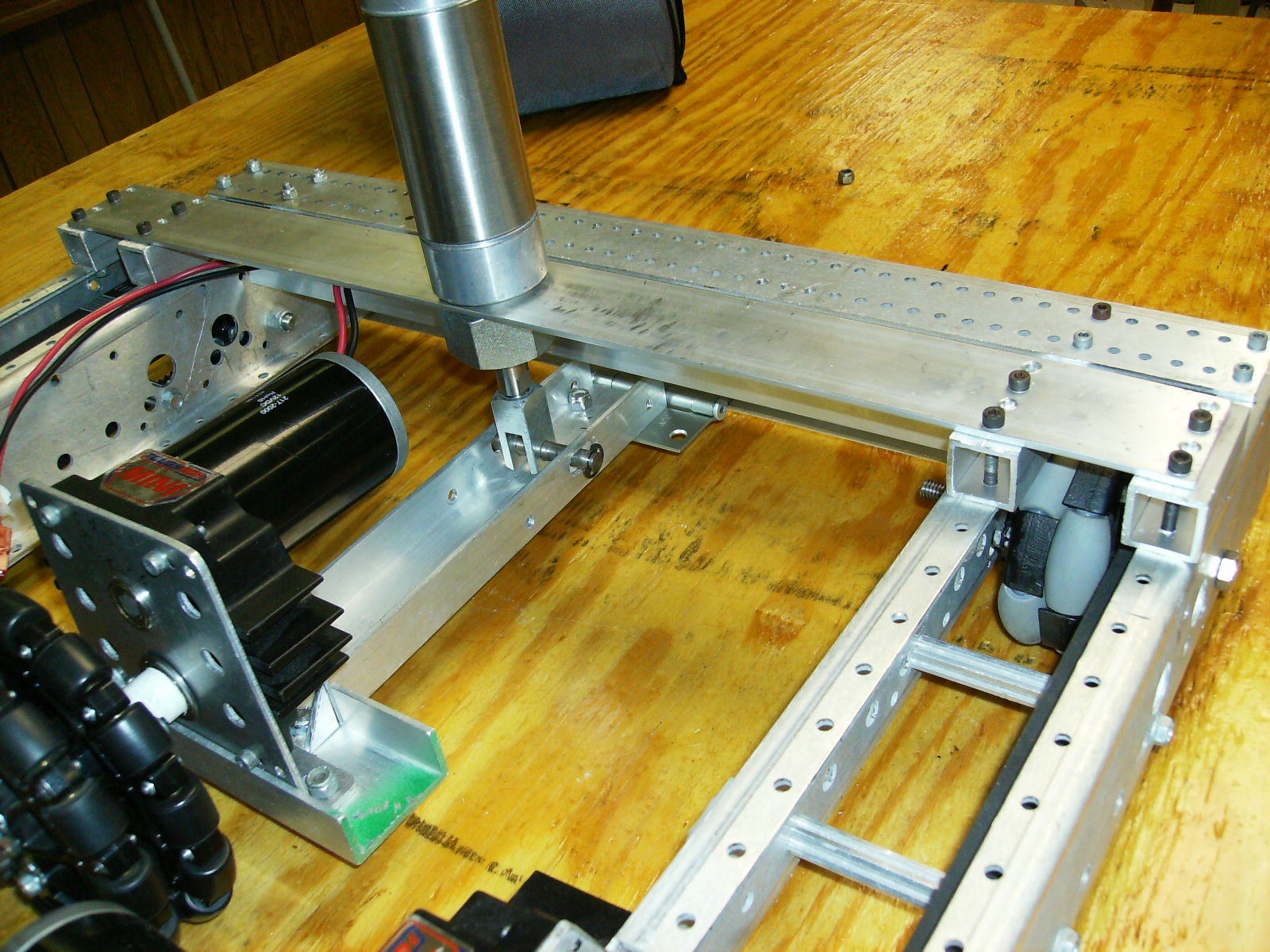

3946 modified a U2 kit chassis to H drive in 2015.
As noted above, you must not have a solid wheel contacting the floor. We solved the problem then by removing the rubber tread from the center wheels. If doing this with the 6" setup, you could just swap the center wheels with 4" wheels and allow them to “float” most of an inch off the carpet, though they would give you some “fun” as you climbed onto the HAB if you’re planning to use this for an offseason robot.
Also as noted, the transverse-mounted wheel must be on a spring or pneumatic mount, or other system which ensures that a steady amount of weight is supported by the center wheel. We tried a variety of altitudes, and nothing worked, even on level carpet. We found that the amount of weight on the wheel varied as a function of acceleration, making control of the robot significantly worse than a simple skid steer. As such, we removed the slide wheel after several matches. Post-season, we did mount an omni slide wheel on a pneumatic pressor, and it worked great once we got the pressure adjusted to the right value (about 25-30% of the weight on the center wheel for us). Note that the post-season slide was on a different robot chassis.
