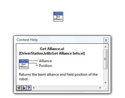

Can I get to similar data within Labview?
I just installed Update 3 and I see there is now WPI Robotics Library > DriverStation > GetAlliance.vi.

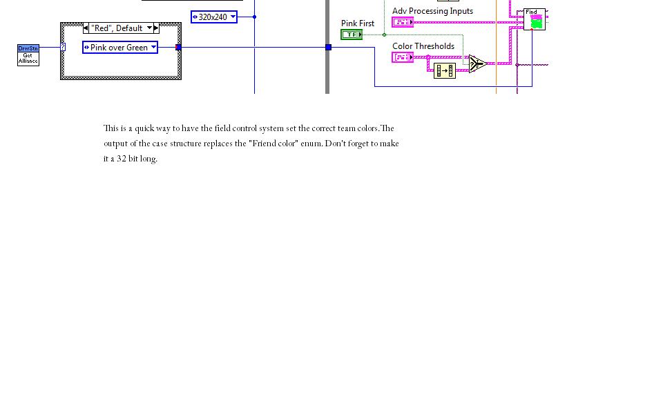

With the new vi you should be able to just replace the “Friend colors” enum with case structure and the “Get Alliance” vi. For testing, just use a switch on the console.
Below is the mod we will try.
