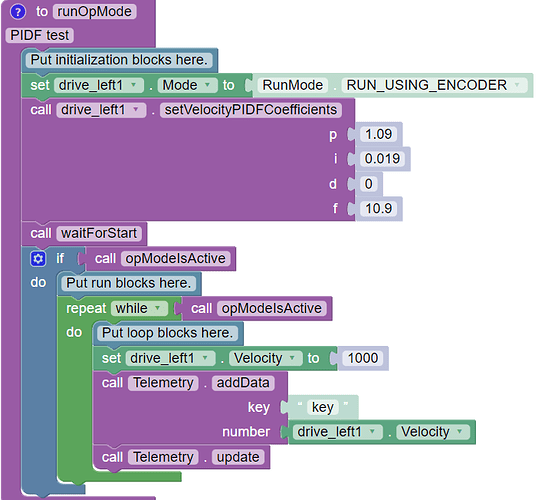

Hello All, I’m struggling in tuning an HD hex motor with the pidf in blocks, I tried as mentioned in the Motor PIDF Tuning Guide - Google Docs to get the P value . But still when I input my PIDF in the PIDF coefficients the motor velocity still plays in the telemetry. Is there any other way to get the PIDF as I can’t find something good in google Thanks
Are you trying to make the motor go a certain speed (velocity), or trying to make the motor go a certain distance?
I’m trying to make it to remain in constant speed ,but in the telemetry I can see that its not keeping stable it plays for example if I set the velocity to 1000 it will play from 980 to 1020 .
1000 what? Rpm? That sounds stable. For velocity controllers a proportinal contrller with a velocity feedforward is good enough

I’m not using this for FTC I’m just experimenting at home to learn how this works and getting crazy :crazy_face:
This is fairly stable. I the resolution of the encoder isn’t amazing it might be as good as you’re going to get. You could try decreasing your kI, and just using FP (and maybe some D). That will at least show how much velocity wiggle you get without I.
But is it good how I m getting the value in using the max velocity as it’s what I’m aware now. Other do you guys use some kind of programs so you can tune the motor ?
The code you’re using is good for driving a motor with Velocity control instead of Power control. If you’re just looking to smooth out the acceleration of the motor, you can use the default coefficients. It’s not necessary to set them yourself.
There are some calculations you can do to get an initial set of coefficients. The tuning is done mostly with trial and error. Even professional engineers do most of their tuning with high fidelity simulations or Monte Carlo Analysis.
Given the low cost of testing for teams, trial and error is the best way to tuning your coefficients. Make sure you’re recording every trial in your Engineering Notebook. If you don’t, you’ll run the same values many times without learning anything new.
We tried to use power and velocity in two separate opmodes just using the mode Run_Using_Encoder . I can’t see allot of difference in the velocity compared when using the power. The only thing I’m trying to figure out is when I use the power and in telemetry I make power and velocity it shows Power-1 Velocity -2870 ,and then when velocity is used instead of power and I set velocity to 2700 in telemetry it shows Power -1 velocity -1400 to 1420. This is all happening under the robot load . And still if I try to put the 1400 velocity as how I understood is what it’s capable to lift under load it won’t keep that velocity it will show almost near 800 in telemetry.
