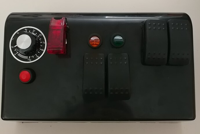

and this is what the custom gamepad looked like
