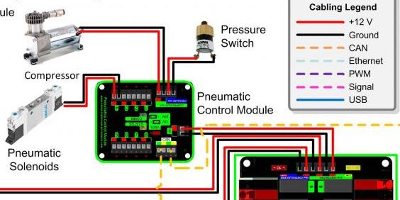

Yup no compressor call needed, I would check the wiring of the pcm . Are either of the small red lights below the PCM channels 0 and 1 lit up? What is the light on the PCM status?
Can you post a picture of your wiring?
Do you have the pneumatic controller hooked up via CAN bus? Is the compressor and the pressure switch also hooked up to the pneumatic controller?
pneumatic

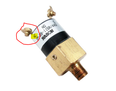

Thank you for the suggestions. All our wiring is correct. The solenoid works correctly. We did not wire up the pressure switch because we only wanted to see if the compressor would come on as we understood it should. We will wire up a pressure switch today and I will get back to you.
That would be the problem because the pressure switch is normally closed (completing the circuit) and when it hits pressure it opens. That way if the wires come off or break the compressor will not work and over pressurize your system.

Yes, it did.
