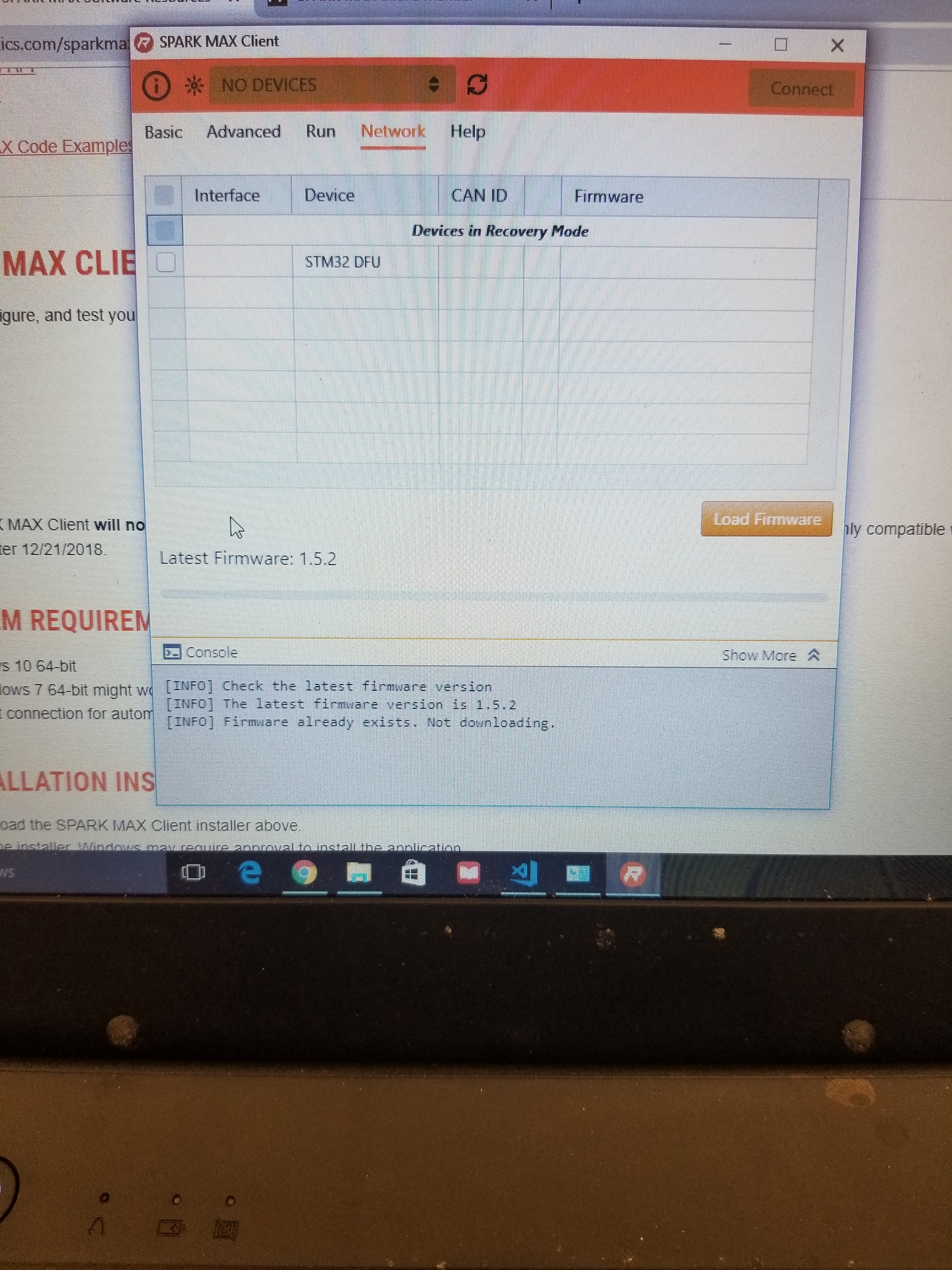

In that case, why have I not been able to update my spark max 1.0.376? When I connect to it, the client tell me I have to put it into recovery mode (something I was told shouldnt need to happen) and when I do I am stuck at this:
I click the refresh and nothing additional shows up and if I load firmware onto what I see there, it says it loaded successfully but it doesnt work
That is an original factory firmware that will require Recovery Mode to get the firmware update onto the device. Firmware that is 1.0.384 or later doesn’t require Recovery Mode to update.
You may need to close the SPARK MAX Client, put the device in recovery mode, reopen the client, and update firmware from the network tab to get the latest firmware to overwrite the original factory firmware. We have a few reports of this issue and are working to recreate the error.

That makes sense but how come I cant get any further than the picture I posted above? What do I do from there?
Okay. I’ll give that a shot. Thanks
