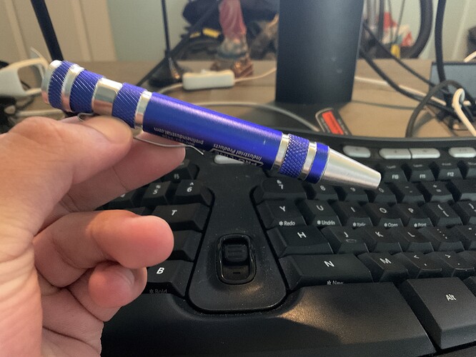

How to i get it unstuck
Context? What exactly is this and what were you doing to get it to this situation?
From what I can see, it appears to be a screwdriver with bit storage, in which case a pair of tweezers and some time should be able to unlodge one of them.
Try percussive maintenance.
Not that I’d for sure recommend any of these methods but… yes more context could help. What is that? which portion needs to become unstuck?

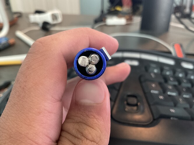

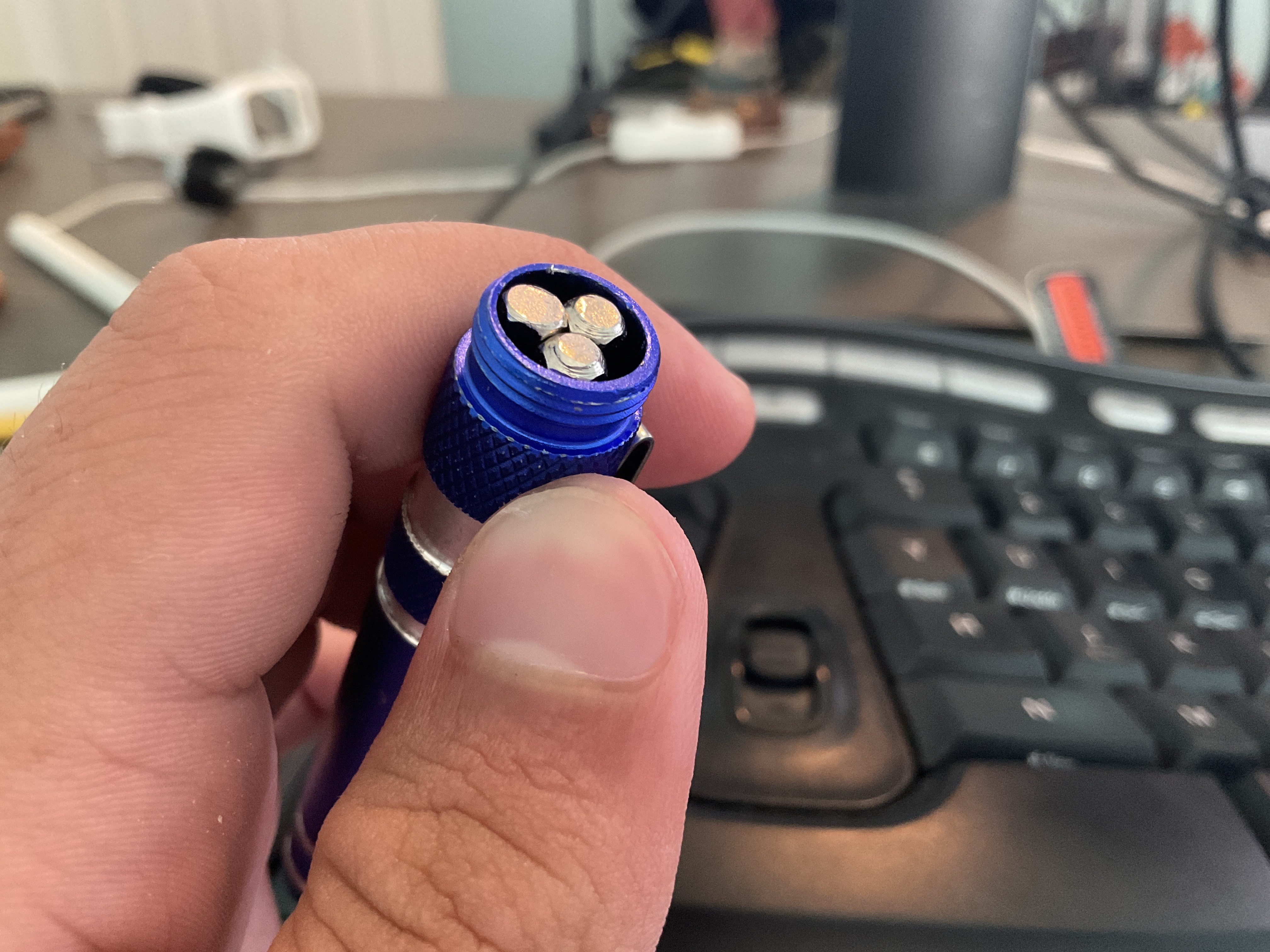

It a screw drive with multiple screw bit, the bits are Hex and lined up perfectly to get stuck at the top, i tried a hammer but, it stayed stuck and just went in further.
If you have a pair of needlenose pliers or tweezers, it looks like that could work?
I unfortunately dont have either at my house

Straighten a wire coat hanger. Make a small 90° bend at the tip such that it fits into the gap between the stuck bits. Insert said straightened hanger with bend into the gap. Turn slightly and pull out a stuck bit.

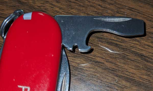

Have a “Swiss Army” knife? There is a notch in the large flat bladed screwdriver, near the base of the bottle opener section. Use that to bend the end of the coat hanger.

If the bits are steel, and the surround is aluminum, you might try heating the whole thing up some (maybe in an oven). The aluminum should expand more than the steel…
