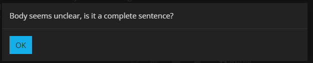

asdfasdfasdfasdf
CD actually stopped me from posting because:
Thanks, love you too.
