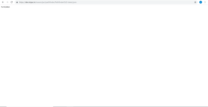

I went to the link for the vender json file they specified on the readme page and
Instead of clicking the link, open VS code, and go to your project. open the command palette (Ctrl + Shift + P) then type…
WPILib: Manage Vendor Libraries > Install New library (Online) > paste the URL.
That way, you can bring all of the library dependencies and the vendor JSON file to your project.
Hope it helped.
