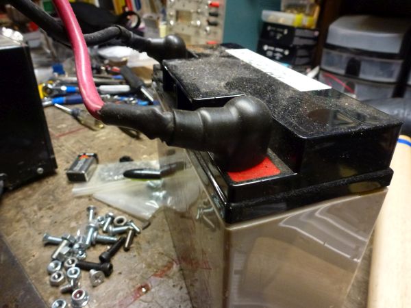

We use battery terminal cover rubber right angle insulating boots.
Similar to these from a quick search, available at battery stores: https://www.aliexpress.com/item/10PCS-Black-Red-Battery-Terminal-Boot-Round-Rubber-Insulating-Cover-Tool-20x12MM/32831095531.html
Not as difficult as you might think. Once you get a little pull somewhere, a pair of needle nose pliers can do a good job pulling it off. We use it on the ends of our 775s as well. If it’s really obstinate, a heat gun will soften it up enough to get a hold of it.

This is also an option if you have a 3d printer:
https://www.thingiverse.com/thing:675138
Ive never used them but they look quite clean.
