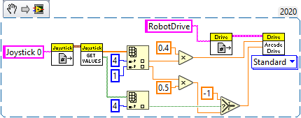

Hi! Me and my team had an ideia of implement a system based in boost our robot speed like:
The robot operates in 70% of his whole potencial, in front-behind commands, uses an Joystick to do it. But, if we press a determined Trigger ou Button, the robot starts using 100% of his motors and speeds up.
I’ve been trying to find a code which make this happens, also, I’ve tried to do it by myself. However, no options brought good results.
Do anyone have an example of way to code like this? We would be grateful!

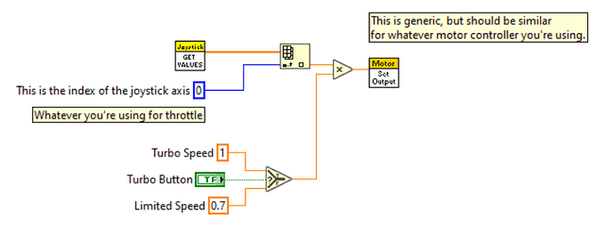

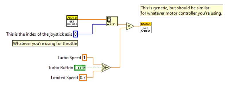

You could have a variable that multiplies the joystick inputs by .7 then when the button is pressed it sets that variable to one instead of .7. Then on the release of that button you set that variable to .7 again.
There are a few ways to do that. If you are just sending a percentage to the motor controller (a -1 to +1), just multiply that output by 0.7 normally, and multiply it by 1 when your ‘turbo’ button is pressed.
You could also treat your ‘turbo’ button as a toggle, where each button press switches between the slower and faster speeds.

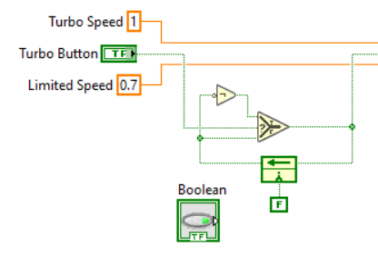

This button besides the “Turbo Button” text, where do I find it? I know it’s related with the True of False, but it isn’t the same as the one used for define the motors rotation side, for example.
That’s actually a LabVIEW control for the front panel of the VI. For the robot, it won’t be useful, because you can’t access it during a match.
If you right click a boolean constant (the T/F box) the list will have an option, ‘Create Control’, and it will create one. The default name will be ‘Boolean’, so it will look like this:
Boolean Control
You can ignore how the ‘Turbo Button’ and ‘Boolean’ look different, they do the same thing.
For your robot, you want the turbo button to actually be a button on your joystick, game controller, whatever plugs into your driver station.

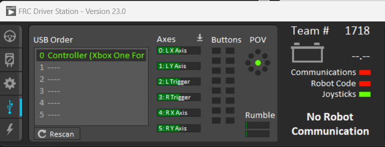

You can use the driver station program to figure out which index corresponds to the button you want. If you go to the tab with the USB symbol, you can press the button on your controller, and it will light up in the display.
The square in the top left under ‘Buttons’ is index ‘0’, and it counts up as you go down the column. If you are using an Xbox controller, the ‘A’ button is usually index 0 (‘B’ is 1, ‘X’ is 2, ‘Y’ is 3).

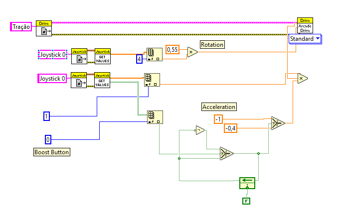

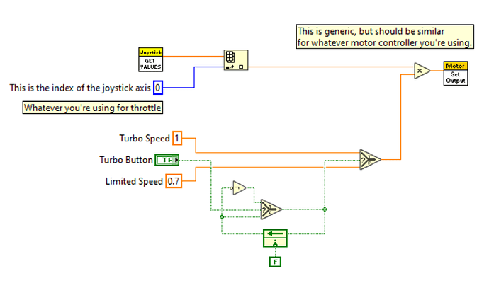

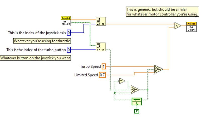

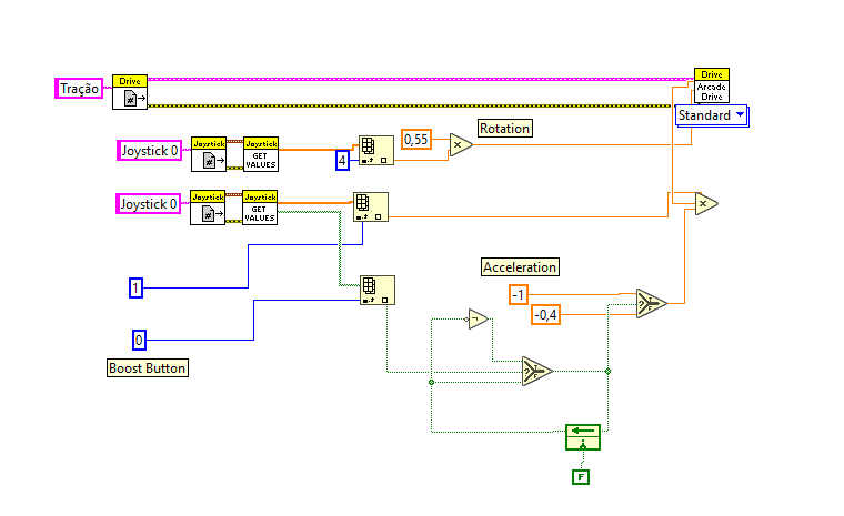

Well, finally I tested this boost code, but it isn’t working as expected. Before I press the Boost Button, the robot oppers in 70% as normal, however, after I click it, the robot uses 100% the whole time, even if the Boost Button is not pressioned anymore. The robot just comes back to 70% if I press both joytsicks and buttons together at the same time, also, this doesn’t work sometimes.
Do I have a way to code for the Boost to 100% just occures while the Boost Button is pressioned and come back to normal after I take my finger off on him?
**Here is the code I’m using now

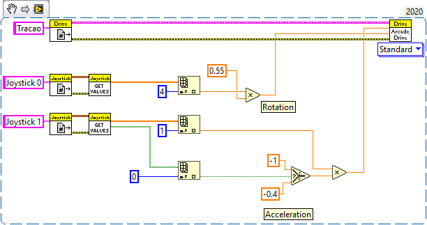

Yes, it’s easy to do that. Just take the boolean wire from the button array, and wire it directly to the select operator that goes between -1 and -0,4.
Could you send me a screenshot of this code in LabVIEW? I don’t know if I done it correctly.
Screenshot 2023-04-12 151541
Look at this example. With this, the turbo only applies when the driver is holding the turbo button. When they let go, it should go back to the slower speed.
Also, I noticed that both of the joystick names were the same name, so I changed it to Joystick 0 and Joystick 1.
Turbo Button Example

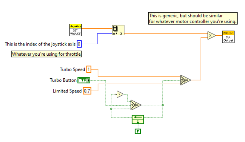

Our team utilized a turbo button this year. We used an xbox controller with the left stick to control forward and backwards and right stick to control turning. We slowed down both forward and back and our turns. We then used the left shoulder button as a “turbo” button that allowed for full power on forward movement only. Our driver said it worked quite well. Here is a snippet of our teleop. It is similar to what PI_Fighter already posted, but slightly different.
turbo

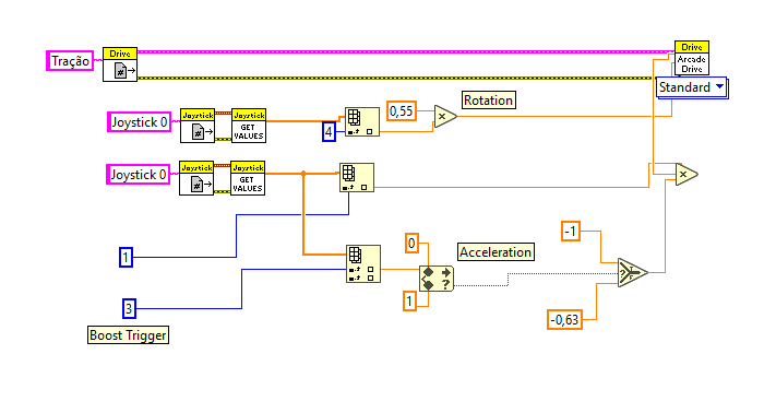

In addiction for this post, I would like to share a way of making my robot boost using not just only buttons, but triggers and analogics this time. For me, this code works pretty well, if you saw any problem on it, contact me for I make a change.
