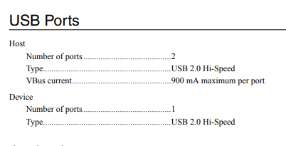

We’ve done this too but have also gotten occasional undervolting this way. Does anyone know what the RoboRio’s USB spec is? I’d be curious to know what it’s current limit is.
this is from their specifications PDF

The roboRIO cannot provide enough power to properly power the raspberry Pi. See https://www.raspberrypi.org/documentation/faqs/#pi-power for the recommended power supply sizing, and the consumption from the Pi itself.
I think it might depend on the pi that you have. they all draw different ammounts
For every version of the Pi except for the Raspberry Pi A and Raspberry Pi A+, the manufacturer recommends using a power supply of over 1A. Typically 2.5A.
The typical usage of a Pi does not require that amount of power, however the peak power usage of a Pi that can be seen under extreme circumstances(namely vision processing) can require more power than can be supplied by the Rio. The average current draw of a 3B while under stress is 850mA, as measured by the manufacturer.

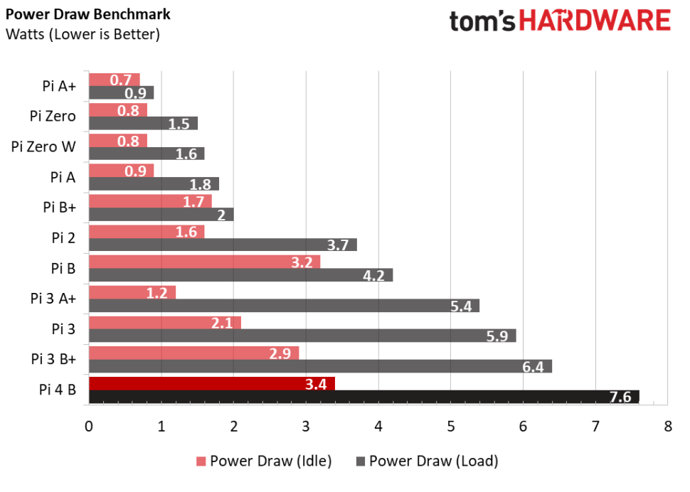

Here is a graph showing power usage for each generation of PI both under load and idle for what it’s worth.

just out of curiosity what are the units
It says that it is Watts
