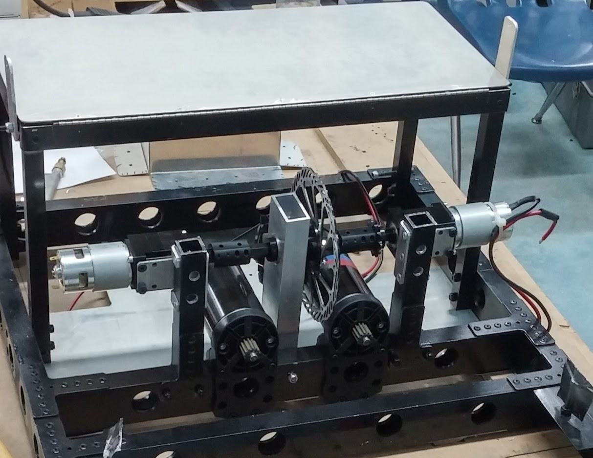

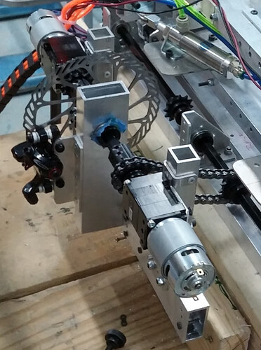

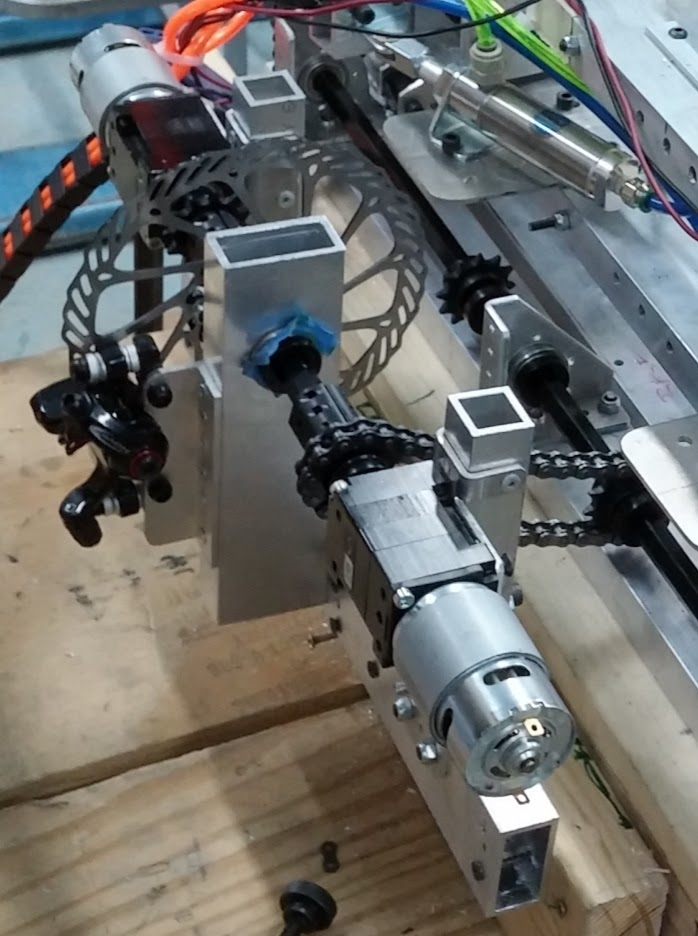

Buy a disc brake kit off Amazon and put it somewhere inline on a hex shaft with a hex hub. The bolt patterns are close enough to mount to stock bicycle discs and you can use a pneumatic actutator to just pull on the brake cable. Easy peasy.
Can you describe this a bit more, Ryan?
Thrifty Disc Brake?
https://www.amazon.com/BlueSunshine-Mechanical-Brake-Front-160mm/dp/B077JVRG6X/ref=mp_s_a_1_6?dchild=1&keywords=disc+brake+bicycle&qid=1579656602&sprefix=disc+brake+bi&sr=8-6
The hole pattern more or less fits with FRC’s 6 bolt hole pattern. Teams have then put them on a hex shaft at some point of their power transfer system and connect a small actuator to pull the cable on the brake caliper, causing it to lock the system up.
We rigged up something like this in our elevator on 4329 in 2015. The team was extremely COTS heavy that year so excuse the goofy inline dual versaplanetaries :slight_smile: Did a fine job holding the elevator’s position with 6 totes though -
Those are ~6" discs but there are smaller ones or you can make your own.
