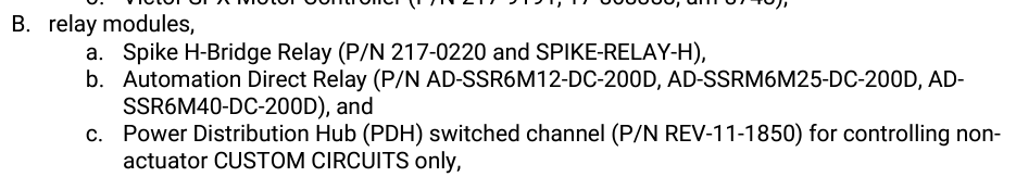

I don’t believe it is legal to control a solenoid from the PDH switchable channel per R504:
R501 defines electric solenoids as actuators.
Whoops! You’re quite correct, I missed the “non-actuator” statement. @AlexT321 you will need to use one of the legal relay options instead of the PDH switched channel to control the solenoid.
Thank you! I will notify my mech team about this
Legal relays don’t give you many options. There’s the automation direct relays or the old Spikes which are not something you can order.
Normal Arduino relays are not legal.
Spike H-Bridge Relay (P/N 217-0220 and SPIKE-RELAY-H), b. Automation Direct Relay (P/N AD-SSR6M12-DC-200D, AD-SSRM6M25-DC-200D, AD­SSR6M40-DC-200D)

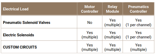

Oh! I will also note that according to R505, you can power electric solenoids off the Pneumatics controllers. Though in this case, I don’t think it will supply enough current. Still good to know!
R505 *Don’t overload controllers. Each power regulating device may control electrical loads per Table 8-2.
Unless otherwise noted, each power regulating device shall control 1 and only 1 electrical load.
Those can usually only output about 200 mA per channel. This solenoid is 24W at 12V, so it will need about 2A.
Edited! Leaving it since its still good info for someone who potentially finds the thread in the future for a lower-power solenoid.
