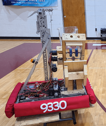

This is simple code we used to run 9330 at competitions, it includes an open loop autonomous mode we wrote in Java (shoots 3 balls in autonomous, plays defense & climbs). Tank drive using split arcade for control. Used java. There’s a lot here you can probably straight up copy.
