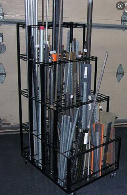

Alternately, fabricate a holder like this:

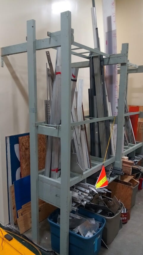

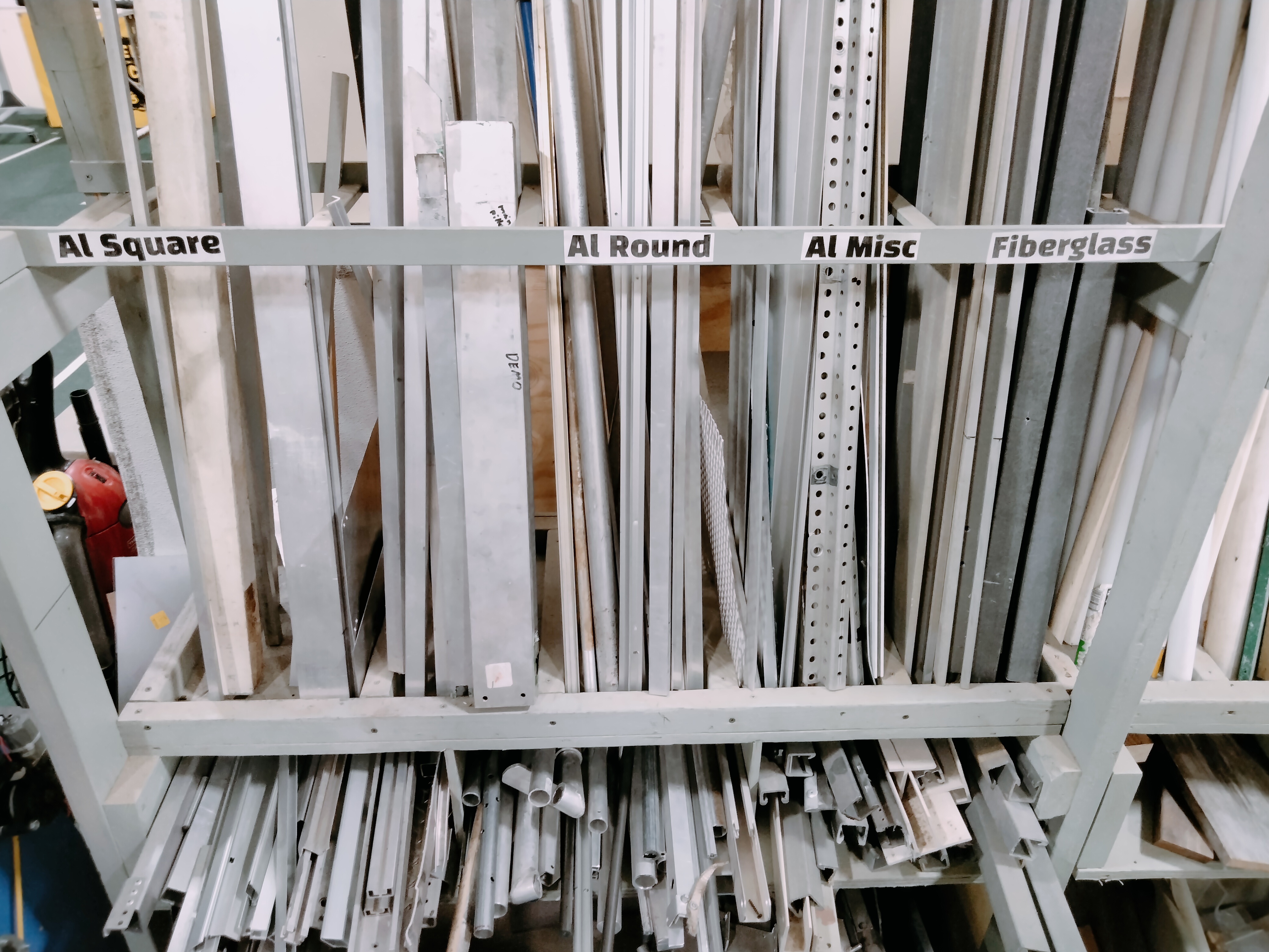

Largely we’ve benefitted having some upright storage for longer things. I built a rack from wood and cable racks a couple years ago to help better manage it for us. I built some room for scrap bins (totes) underneath, and then a row of useful length (~2 ft) boxes below the upright section. Long upright stock tends to lean enough in wide bins that if was harder to place against the wall, but we use the space behind for flat stock pieces.
This does take a big area, but largely was unused anyhow. Now rid of a bunch of minimally useful material would help us, but it is easy to gather all sort of things, and hard to let go.

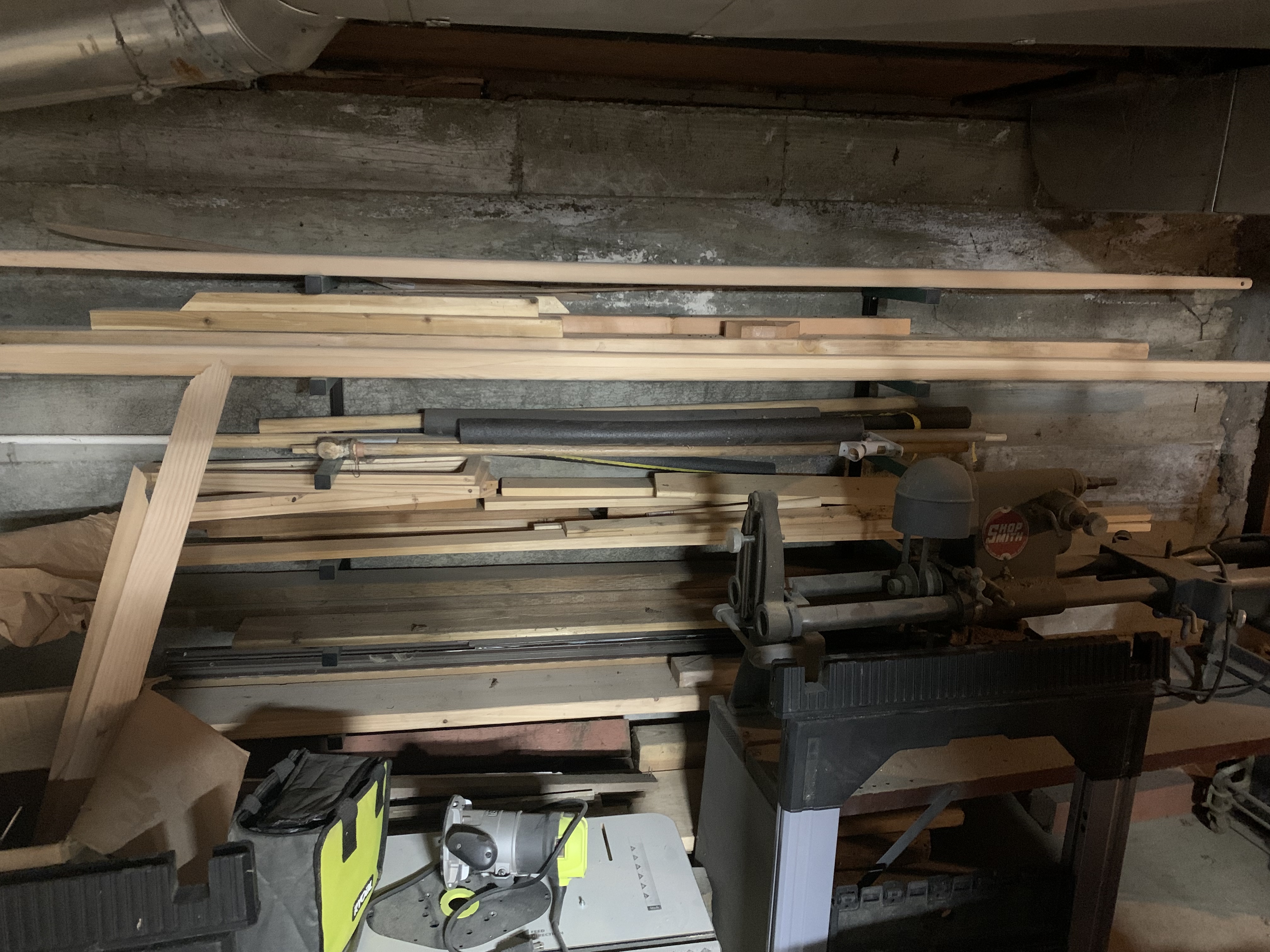

I’ve used this screwed into a brick wall with Tapcon screws. It worked well. https://www.amazon.com/PortaMate-PBR-001-Organizer-Storage-6-Level/dp/B004DGIZMW
I have the Grizzly equivalent in my basement to manage the random 2x4s and other things, amazing how much stuff you can store and how much it cleans up your space. Definitely recommend the hammer drill though, a masonry bit and a regular drill will eventually get it done, but you’ll have a bad time.

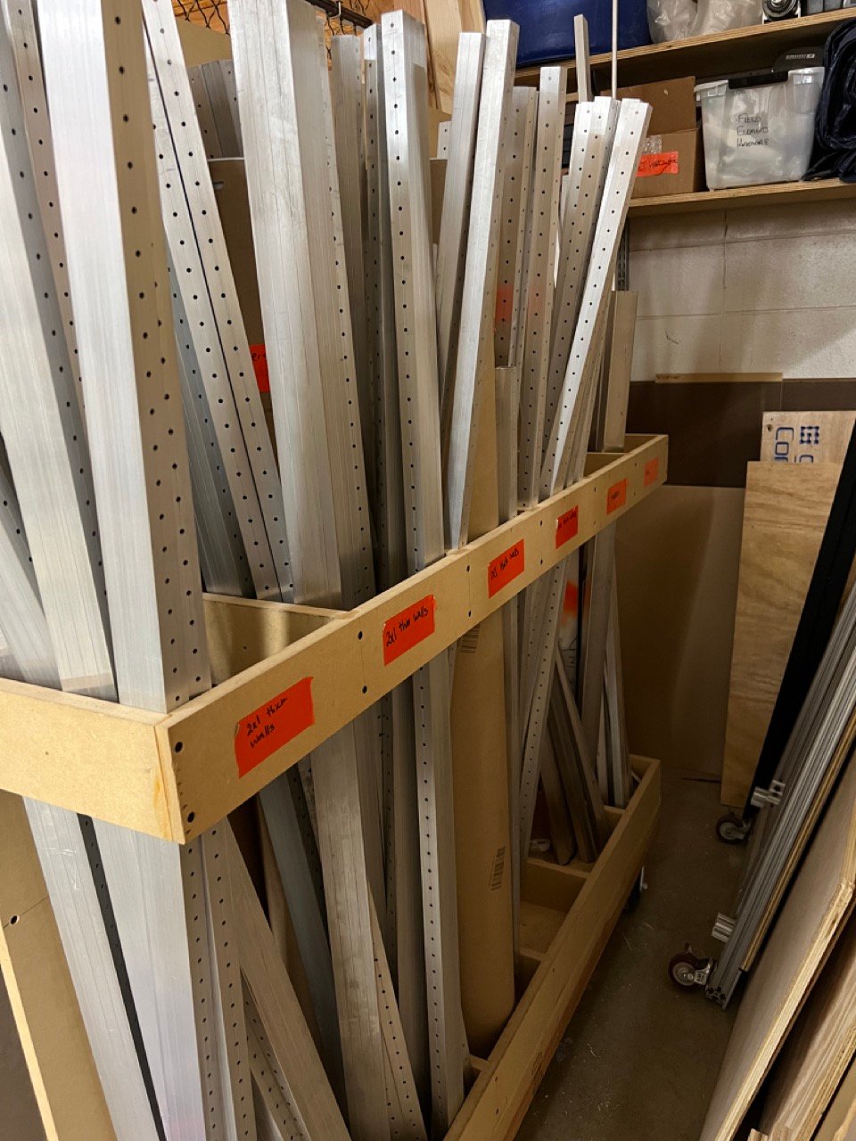

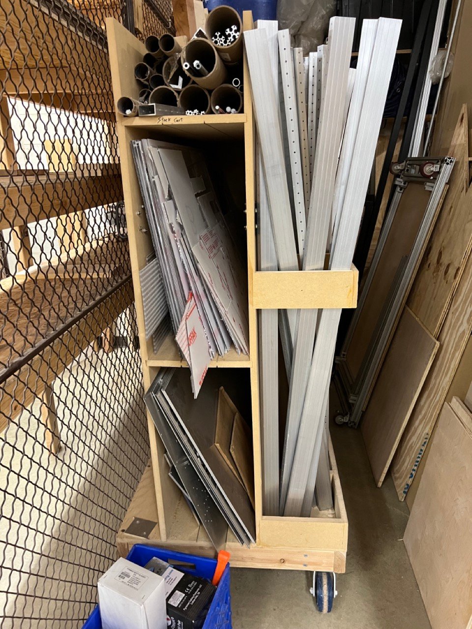

We needed a moveable cart to hold our stock and sheet goods. We built a custom one that has served us well for a number of years. Sheet goods and rods are stored on one end and tube stock on the side.

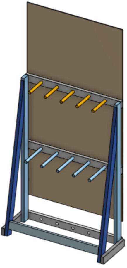

We made this:
2x4s, 1-1/4 dowels and a sheet of 1/4 plywood as a wall protector. It holds a lot of long stock. We try to limit our long stock to 8’ sections. Easy fall project.
