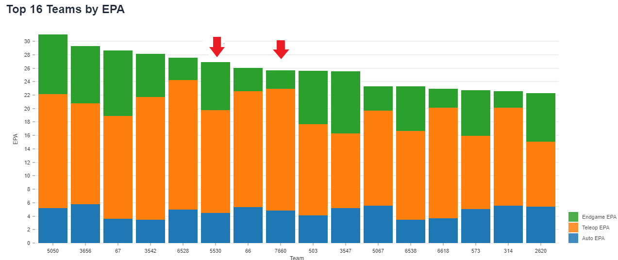

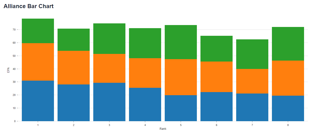

If you are like me and want to assess how an alliance pulled off a playoff upset, then your first stop is the Alliances tab for an event on Statbotics. Let’s pull up Lincoln 2019 and take a look at those bar charts (using Expected Points Added or EPA as a rough metric for robot ability).
Evenly matched alliances are the first ingredient in the upset special recipe, and the parity at Lincoln is immediately apparent. This level of competitiveness requires a deep field of robots from which to pick during both rounds of alliance selection. The data supports this: Lincoln featured the 10th highest average EPA and the 12th highest Top 24 EPA out of all district and regional events in 2019.
This means the 8th alliance captain, 5853, FEAR the Termigators, had plenty of strong robots available when it was their turn. They ended up selecting 5530, The Greenhills Lawnmowers, and 7660, The Byting Irish. Let’s switch to the Figures tab to get a sense of 5530’s and 7660’s relative ability.
Even considering Lincoln’s competitiveness, it is probably shocking that the 6th and 8th best robots by EPA were still available for the 8th captain. Let’s explore the contributing factors.
Since EPA was not a widely available metric in 2019, OPR (Offensive Power Rating) was the best option for teams without robust scouting operations to use as a holistic metric of robot performance. 5530 and 7660 had the 11th and 13th best OPR at Lincoln respectively, making their availability at the end of the first round a bit more understandable.
However, switching to OPR raises just as many questions about the draft order. For example, some of the teams with the best OPR were not picked until the middle of the second round. Conversely, the 3rd overall pick barely cracked the top 20 for OPR. Clearly, OPR (and EPA by extension) have serious limitations when it comes to explaining the selections made by alliance captains. This indicates specific capabilities were valued higher than overall performance.
Sure enough, the field of teams at Lincoln featured a wide variety of robot archetypes with few all-around exceptional teams. Robots could largely be sorted into a couple categories: “Climbers” who ranked high but struggled with speed or game piece manipulation, “Hatch” or “Cargo Specialists” who focused on 1 game piece, and “Everybot” class robots who scored fast, but were limited in where they could collect and score game pieces. knowing their own strengths and weakenesses, alliance captains often needed to pick a robots that offset their own robot’s deficiencies.
A good visualization of the different robot capabilities can be found in the graphs produced that year by Alicia Bay using Caleb Sykes scouting database. Between the two graphs, you can get a sense of the strong Cargo or Hatch bots (Game Element Analysis) and the strong Climbers (Overall Earned Points Analysis). Once you filter down to FIM Lincoln on the graphs, make sure to also set the 2 filters in the bottom right corner to show “All”, otherwise you’ll only see the robots that qualified for the World Championships.
The 3rd alliance from Lincoln is a good case study of how this affected alliance selection. The captain, 3656, was among the strongest climbers and a consistent cargo scorer, hence their high rank. However, they had a limited ability to score hatches, leading them to pick 6570, the best Hatch specialist at the competition who could score at all locations. In the second round, they snatched the best overall game piece scorer available in 5067. While you could quibble that such and such robot would have been a better selection, the 3rd alliance’s Finalist medals vindicate 3656’s alliance selection strategy.
