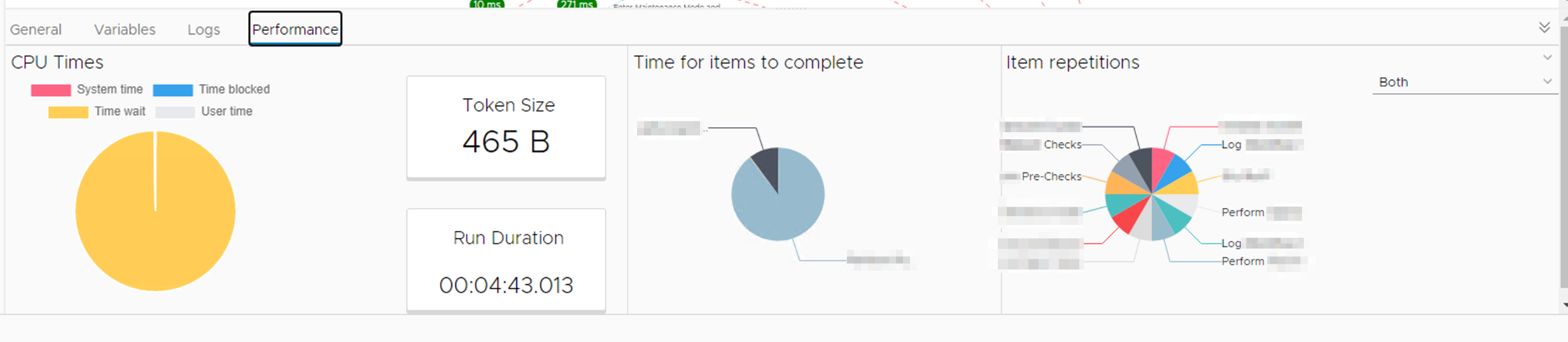

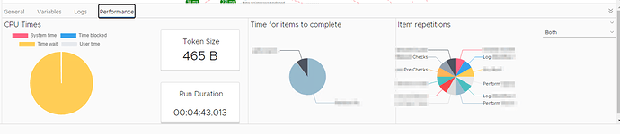

As an example, this is one of the metric indicators that I use regularly:
Lots of great information exposed in some simple graphs. I can also flip back to the “logs” tab to get all of the logs. The DS logging interface leaves something to be desired at times, for me at least.
