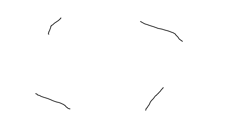

So how to graph the ProfiledPIDController’s setpoint and the goal . l think it will help me tune it. Besides , can l use the sysid to tune the profiledpidcontroller. And how should l do that. l think that l should let the swerve in a rotation behave and lock the swerve’s wheel , maybe the wheel should like below:
And then l should run the four tests on the sysid and get the kP feedback . But how can l make sure that the unit of kP is consistent with mine?
Such a test will certainly work, provided you can lock the modules correctly. You’ll have to do the math to convert from motor rotations to robot rotations (the wheels are moving in a circle, so just figure out how many times the wheels turn per robot rotation and proceed from there).

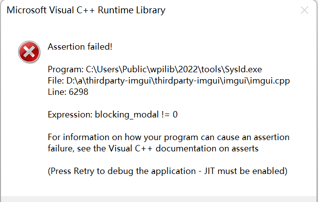

What does this mean?
It means your motion threshold is too high, most likely.
What should l change?
After l have chosen the forward in the sysid , it can’t be opened again.\
Make sure you have the most recent version of SysId.
Also, delete sysid.json and sysid-window.json.
l use WPILIB 2022.2.1
Where are these two files?
Thanks , it is now OK!
$HOME/AppData/Roaming
