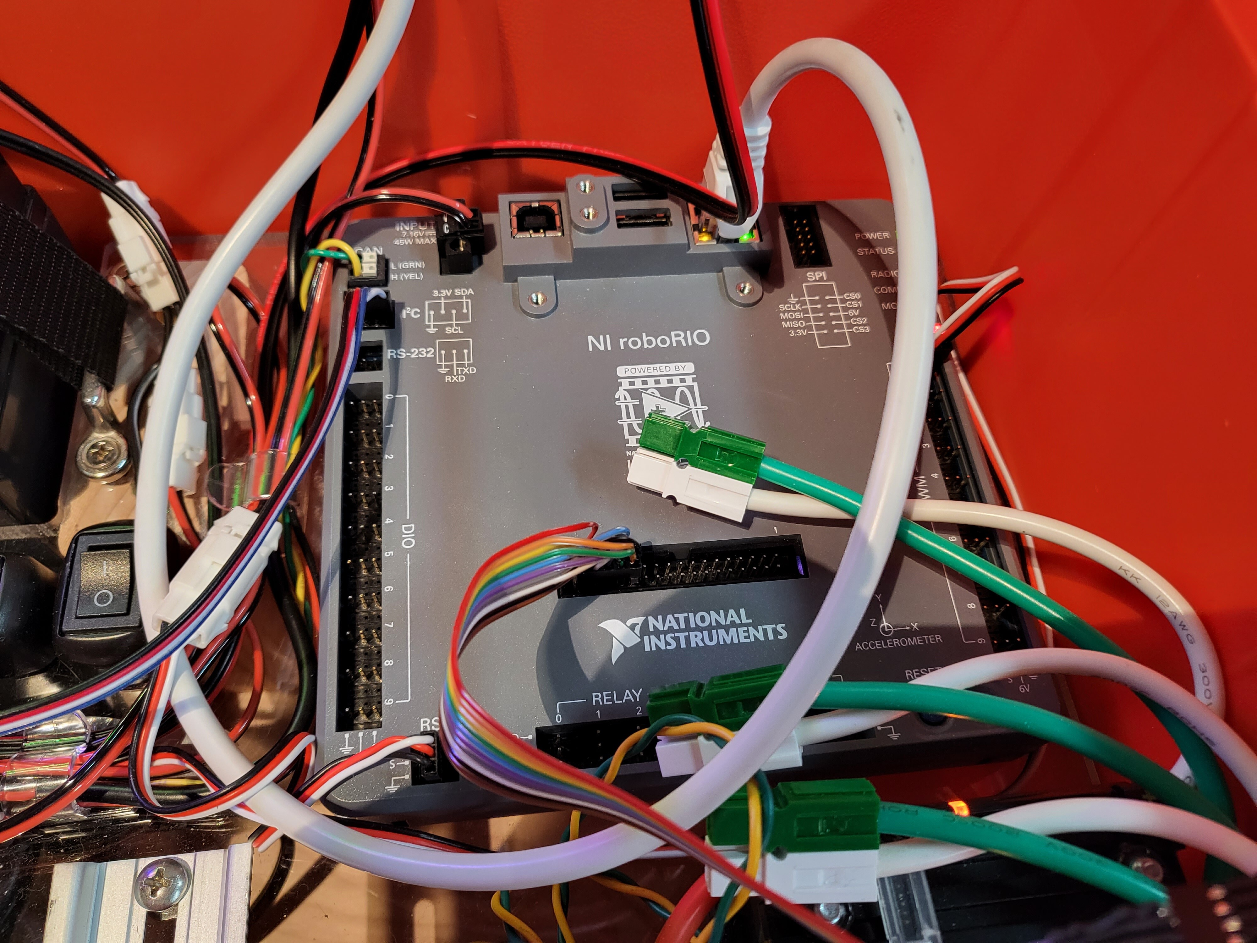

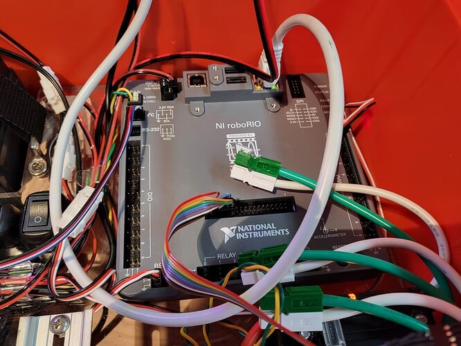

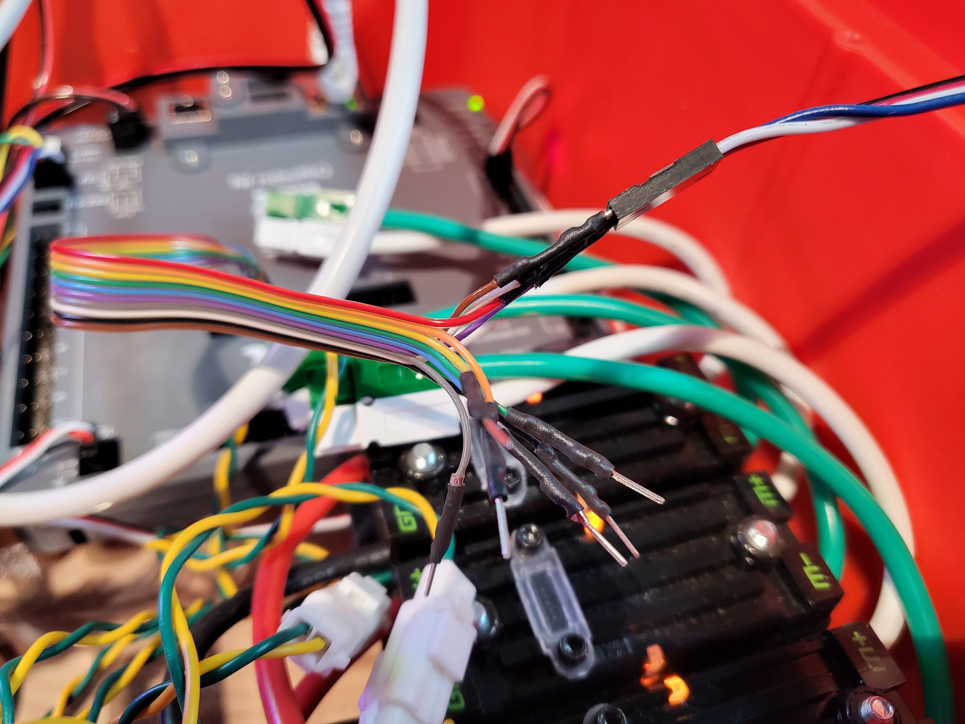

FYI - Team 1967 here - we were able to utilize two of the color sensors without a multiplexer by using the 34-pin expansion connector. Others here have mentioned theory and/or noted success, but I’ll add to it a photo of our prototype connections and also note the following regarding software:
The Color sensor has a constructor argument asking for an I2C “port” - this port is either the onboard port that most people use in the upper left of the roboRio or it is the expansion connector I2C port. The expansion connector is known as “MXP” and in Java, the two enumerated values used in the constructor are either:
I2C.Port.kOnboard
I2C.Port.kMXP
Please see the warnings regarding use of the onboard I2C port. It may work for you, but fail for others, or fail unpredictably. I would recommend looking at the alternatives linked to under the known issues page.
