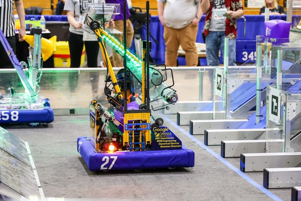

Other teams had interesting uses. 27 used it as their arm.

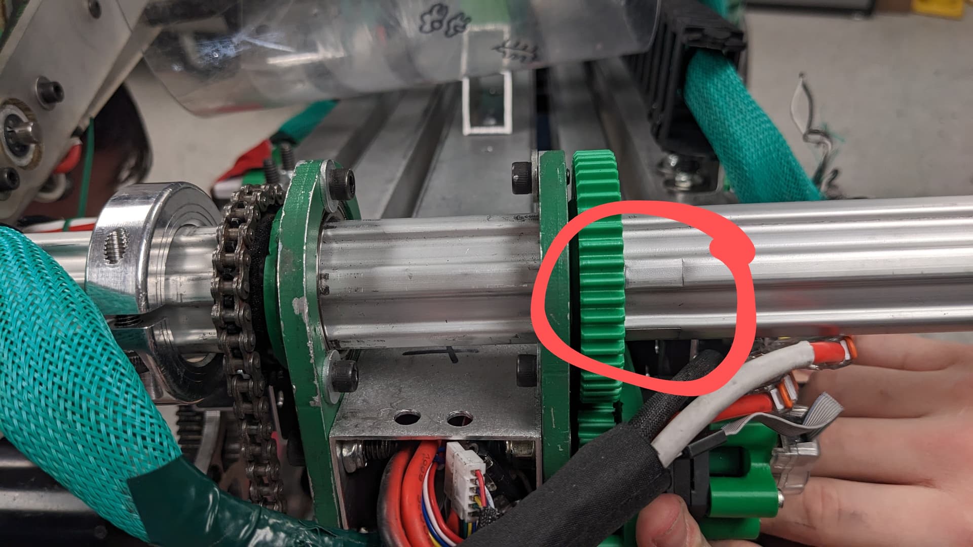

You can use maxspline as a live axle with 35mm ID bearings. We used these:
If we did it again, i’d 3D print some kind of splined insert or use wider bearings because they tended to deform the shaft under heavy loads, making the joint a little sloppy over time.
These plain bearings would also work:
I would love to see more what you saw for deformation! Would an insert inside of the MaxSpline prevent what you saw?
Our loads were placed a long way from the bearing, so we were asking more from this shaft than was reasonable. It held up pretty well considering.
