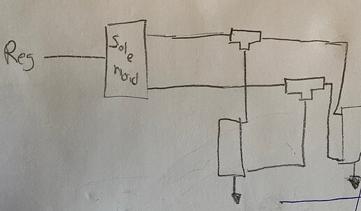

Hey everyone! This is my first post on this site, and I am in a bit of a bind. The robot that I am building would operate much more consistently with two pneumatic cylinders performing identical actions on either side of my contraption. However, I only have one air compressor and one pressure gauge. We have multiple solenoids and multiple air cylinders. How would I set this up? Is it even possible to do what I am asking? Any helpful replies are much appreciated.
Use T fittings to split the lines after the primary regulator. Or use a manifold for your solenoids, it’s a bit cleaner.
If you want the two cylinders to operate identically, then use a tee-fitting after each of the solenoid outputs.
If you want the cylinders to operate as identically as possible (if not mechanically linked) make sure all the tubing between the reservoir and the solenoid(s) and the solenoids to the cylinders is the same length (or as close as you can get it)
If using a manifold for the solenoid(s), just worry about the distance from the manifold outputs to the cylinders.
Tldr; make the tube lengths the same after the solenoid.

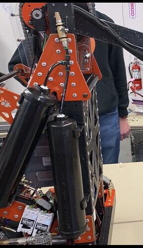

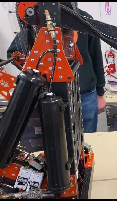

You’ve received some good advice. If it doesn’t seem to make sense in terms of your setup, please post a photo of your pneumatics.
Please note that while the official guide is a great resource and it will show you legal ways to plumb your pneumatics, it doesn’t show all the legal ways in which you might do so. For example, we like our pressure release valve to be high and very obvious, so this year, it was convenient for us to use the second tank connections to do so (we could have used only one of them and plugged the other, but this looked cooler :wink: ).

I’ll just add here that the solenoid has a maximum flow rate, so if you are moving large volume cylinders and split the output after the solenoid, that flow rate will be split between the two cylinders and each will extend about half as fast. If you need to extend two large cylinders quickly, you should use two solenoids with the T connectors before the solenoid input, and make sure in code you’re switching both solenoids at the same time (or plug them both into the same ports on the PCM/PH depending on how much current they draw).
