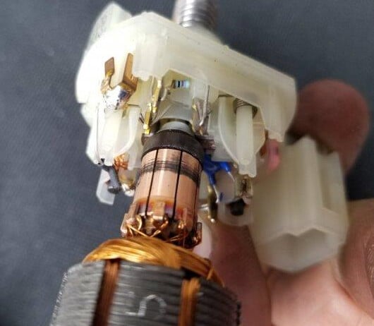

The dark ring just above the Copper commutator is the magnet:
Sorry about the low res on these pictures; I took them years ago…
I have partially pulled out the motor so you can see the small black square on the side of the pocket; that’s the Hall sensor. I never managed to get a data sheet from Allegro :frowning:
You can look at this sensor as an analog signal; it just won’t work very well and will require quite a bit of programming overhead to convert it into pulses/counts. It really wants to be a digital signal! The one advantage of that method is you only need one series resistor to make it work.
