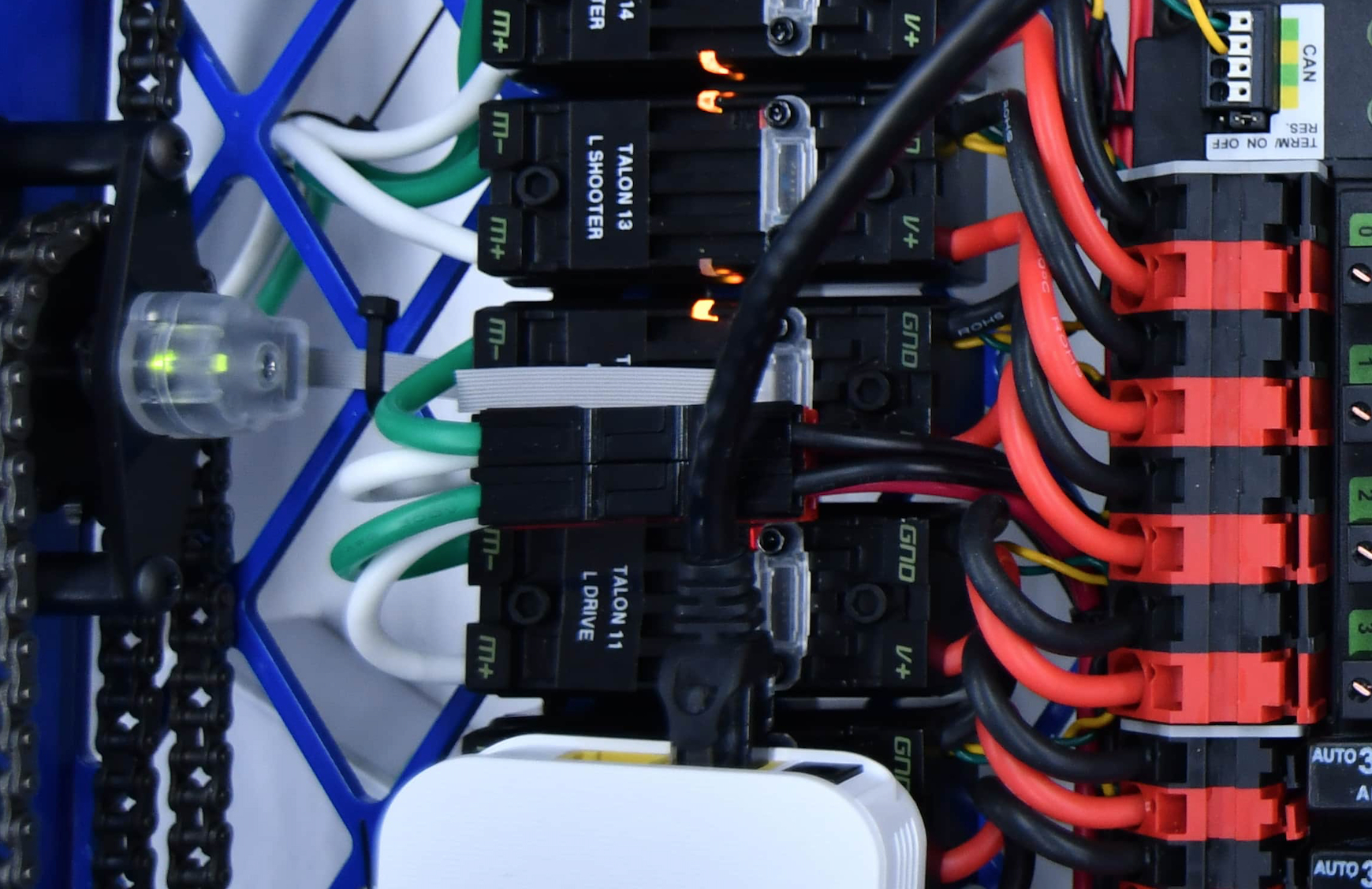

The encoders, boards, and wires that are for the Talon SRX allow you to connect the encoder directly to the speed controller. In this way you can offload your control loops that use the encoder to the speed controller’s processor.
There are two “ends” of an encoder–the mechanical input, and the electric output. The motor or gearbox turns the encoder, and the electrical output goes to an electronic device to be used by a program, to control the motor speed, based on what the encoder tells it the motor is doing.
If the encoder is connected to a speed controller, then it is likely that the speed controller is connected to the roborio via a CAN bus.
If the encoder is not electrically connected directly to the speed controller, then you need to connect it to the roborio, instead.
There is a lot to it…once you get the encoder installed to the motor or gearbox, and connected to a speed controller or the roborio, you then need to program it to do something, such as control the motor speed, based on the encoder feedback.

I see your point about wire management of encoders. So I may install the magnetic encoder on the motor and then use the cable to connect the encoder and Talon SRX. I saw some pictures about this. The reboRio could receive the feedback through the CAN wire on Talon SRX right?
Oh thank u. It seems I thought too much…:sweat_smile:
That’s correct.
