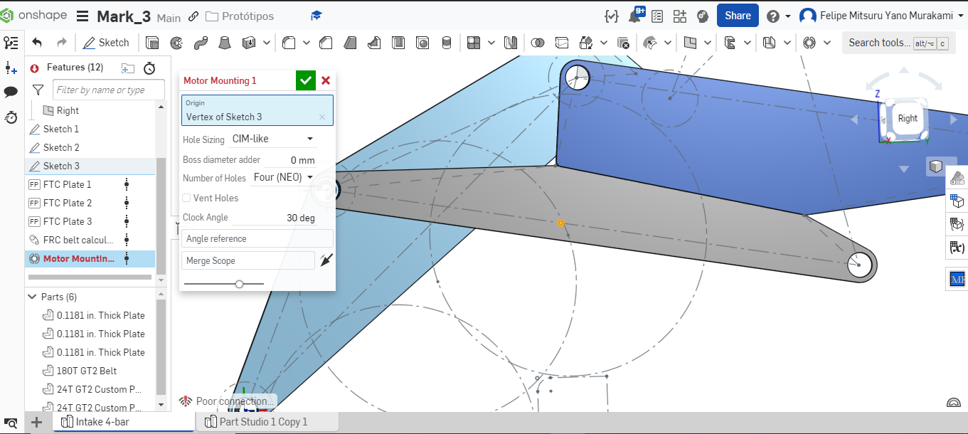

Hi guys, I’m trying to use this tool to add the NEO engine holes. but for some reason the tool is giving an error. Is there something wrong I’m doing or do I need to do something else?
After taking a quick look, haven’t used the feature before, try adding a part as merge scope?
This is what I did and it seems to work
In the spirit of teaching someone to fish, when you see a red title in your operation, you can hover over it to get some information about what is wrong.
In this case, I’m not sure if “No target parts selected for hole” leads a novice directly to needing to provide a part in the Merge Scope field, but it’s a pretty good clue. Be sure to check those error messages on this or other operations. They might help you solve problems.

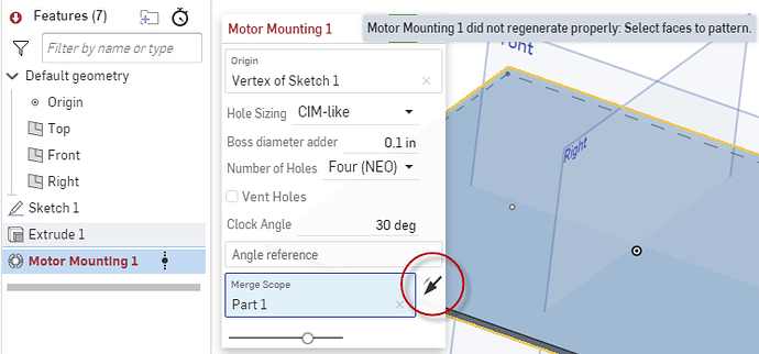

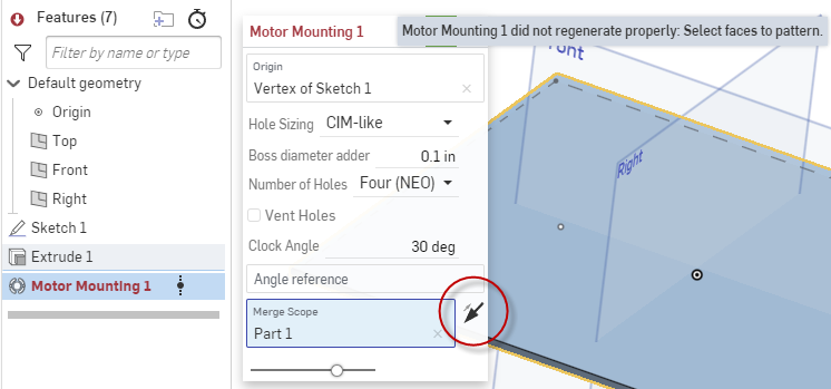

In this particular case, I can create a different error with Motor Mounting. If I create Part 1 by extruding a rectangle “up” from the Top plane, and then I use Motor Mounting and choose an Origin point on the sketch used to create the part, I get an error that the script can’t find the right face to initiate the Motor Mounting edits. This is with the desired part in Merge Scope.
What you need to do in this case is use the “Flip Extrude” arrow by Merge Scope to flip the direction of the extrude so the script can “find” the part.
