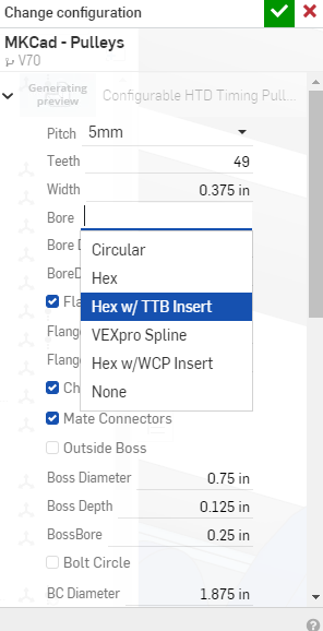

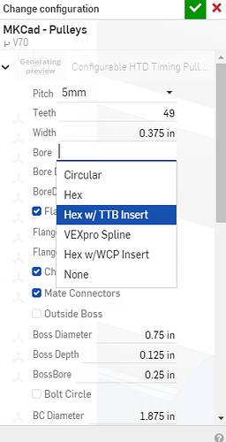

If you are using Onshape, there are a few helpful options to simplify your design.
  1. MKCAD-Pulleys has an option to add a TTB or WCP hex insert to your bore.
  2. For more generic use, there is a Thrifty Insert feature script that will do the job.
ThriftyBot has a guide for other CAD packages as well.
