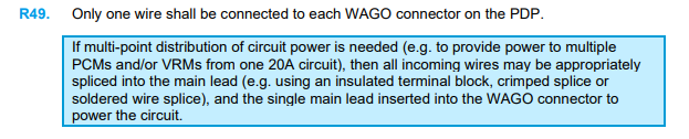

Our team did a custom circuit by using the CTRE Power Distribution Breakout PCB. This allows you to use a single VRM port and connect all 4 or more CANCoders to it.
Yes. We used two of the Wago connecters one for red and one black wire. We had one wire going to the PDP then basically used the Wago to splice the other wires in.
This is specifically allowed in the blue box in R49 in my opinion.
I am not a LRI, but am typically a robot inspector. If I were looking at a robot that had a custom circuit such as this. The main thing that I would require is that the breaker on the PDP was sized appropriately for the wiring on the custom circuit.
I would power all the CANcoders off of a single 12v 500ma port on the VRM. With them plugged into the 12V 500mA vrm port, it qualifies as both a custom circuit and a signal level circuit, which gives you a bunch of freedom in the rules. I would still recommend splicing all 6 of them together and having a single wire going in the VRM port. They each draw 60mA maximum, so power draw is not a concern with 6 of them on a single 500mA port.
