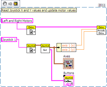

We want to be able to use the Logitech F310 controller to drive our robot with tank drive (using the Y axis of each joystick on the controller to run their respective drive motors on each side of the robot), and we can’t figure out how. All of the things we’ve found online are for the Attack controllers, and use two USB ports rather than 1. Any help would be much appreciated.
In Labview, the programmers should use Unbundle By Name for the axes wire of the Get Joystick vi, or use the Get Axis vi and use axis 2 and axis 4, these are the Y axis of the two main joysticks.

In LabVIEW, it’s very easy to see which controls on the gamepad are associated with the various buttons and axes. Just attach indicators to the existing Joystick Get in Teleop. Run the Robot Main vi and look at the Teleop front panel as you play with the joystick.
I still dont understand how to use the two mini-joysticks on the F310 gamepad as a tank drive.
Axis 2 is the left Y axis. Axis 5 is the right Y axis. Use those as the inputs to a standard tank drive function.
