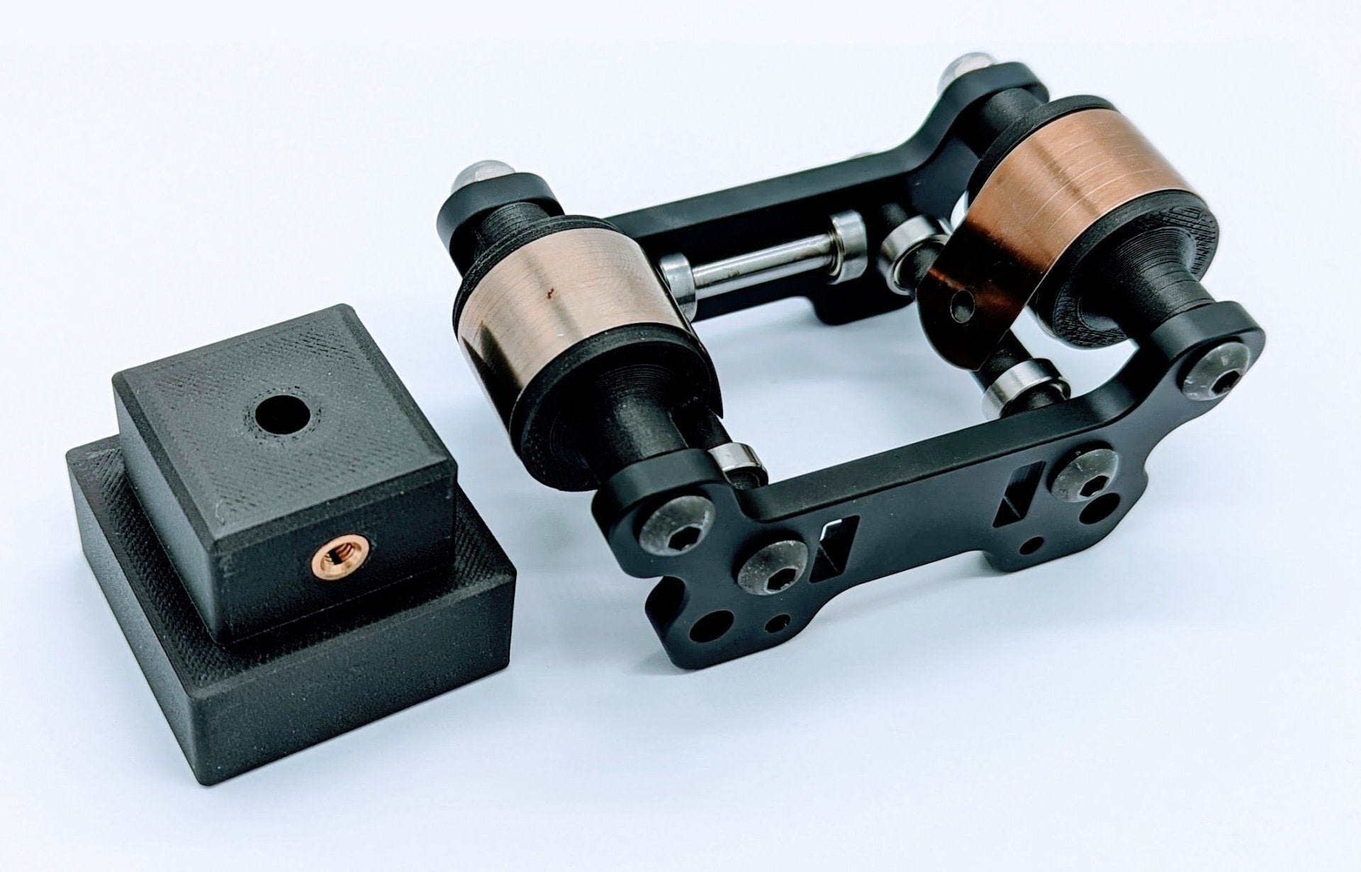

How would you do this?
does anyone know how these things are made or how i can find something like it.
You could mill this but it would take a lot of tool changes and 5 different setups (top and one for each side).
If it doesn’t have to metal you could also print it, though if any hole sizes are critical you will would likely need to redrill them after a print.
Or simplify the design if certain details aren’t so important. Depending how large this is, those internal corner cylindrical channels look especially challenging to mill with how long and narrow they are.
There is alot of wasted material if you mill this, i would find a way to save some material by hand cutting those large chunks (almost entirely that way you dont screw up by accident) out then let the mill precision cut everything, it saves you alot of time and material can be recycled easier this way.

If you’re making 1 a hog out is the only practical way to make it quickly. Also if you need a good surface finish.
If it’s the right material and you have connections you can print it but the post processing may drive the cost as high or higher than milling. Especially if the material and properties require HIP
There are many, many ways to make most widgets. But there isn’t enough info provided to give a more accurate answer. What is it made out of? How big is it? What are the tolerances? What is the surface finish? What is the quantity? What is the budget? Anything else “special” about this part?
Answering most of the above would help determine the most efficient way to make it.
If this is a single/few fictional part, and assuming it’s laptop-ish size, I’d make it on a milling machine as other have said. Several setup and tool changes.
If I had a machining center with a rotary tombstone, it could be two setups; one to face the top, machine the big square hole. The other to make the features on the four sides with a rotary indexer and tombstone type of mounting.

re: internal corner cylindrical channels look especially challenging to mill
I’d guess it’s clearance for a sharp corner thing that fits in the square. Regardless, I’d drill the four corner before cutting the sqare.
Looks like a bearing block for a tube in tube telescoping assembly. So I’d maybe 3D print that, or go way simpler and just machine a Delrin slider block
Your question implies that it’s not something that you guys designed in CAD, but is, instead, something you imported from elsewhere. Where did you find it?
And, how big is it? What’s the height?
If you guys designed it yourself, a number of those holes are very close to the edges, so those holes are not going to be very strong.
First preference: I wouldn’t. If a student came to me with this design I’d tell them “no” and we’d go to the whiteboard, back up a step, and find a way to tweak the design to not require it.
Second preference: If the design truly couldn’t work without this and we were too late to pivot, I’d turn this into 4 simpler parts and bolt them together, maybe with some pins and slots to index them together. It would be cheaper, easier, (probably) faster, and lower risk.
Third preference: If we were somehow backed into a corner where the only option were to manufacture this part: It would require at least 5 setups in the mill. I’m not an expert machinist, but I could probably step-by-step my way through it.

I agree with @BordomBeThyName on “just no”
But if I had to machine it… I’d modify it so the slots for bearings went to the top and bottom surface so I could do it in 2 setups (top and bottom) and then print a drill guide block and do the side holes on a drill press.
The what I assume is a bearing hole, I’d remove it entirely, make it clearance for the shaft and then make a block that filled that space so I could skip that hole.
Try 1 would be print it though.
Echoing the above
  1. don’t. Time for a redesign or go to COTS. If it has to be metal try to make it out of two parallel plates joined by fasteners. Otherwise see point 2.
  2. 3d print with design alterations to remove unnecessary/minimally useful features and beef up what matters.
  3. If there is no way around it: simplify, try to get it out of two plates, reduce any features that aren’t holes, try to get it made in 2-3 set ups on a mill max.
