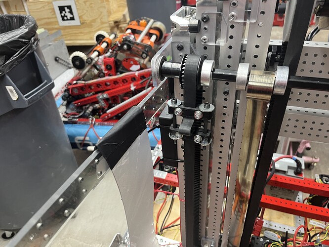

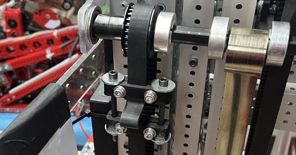

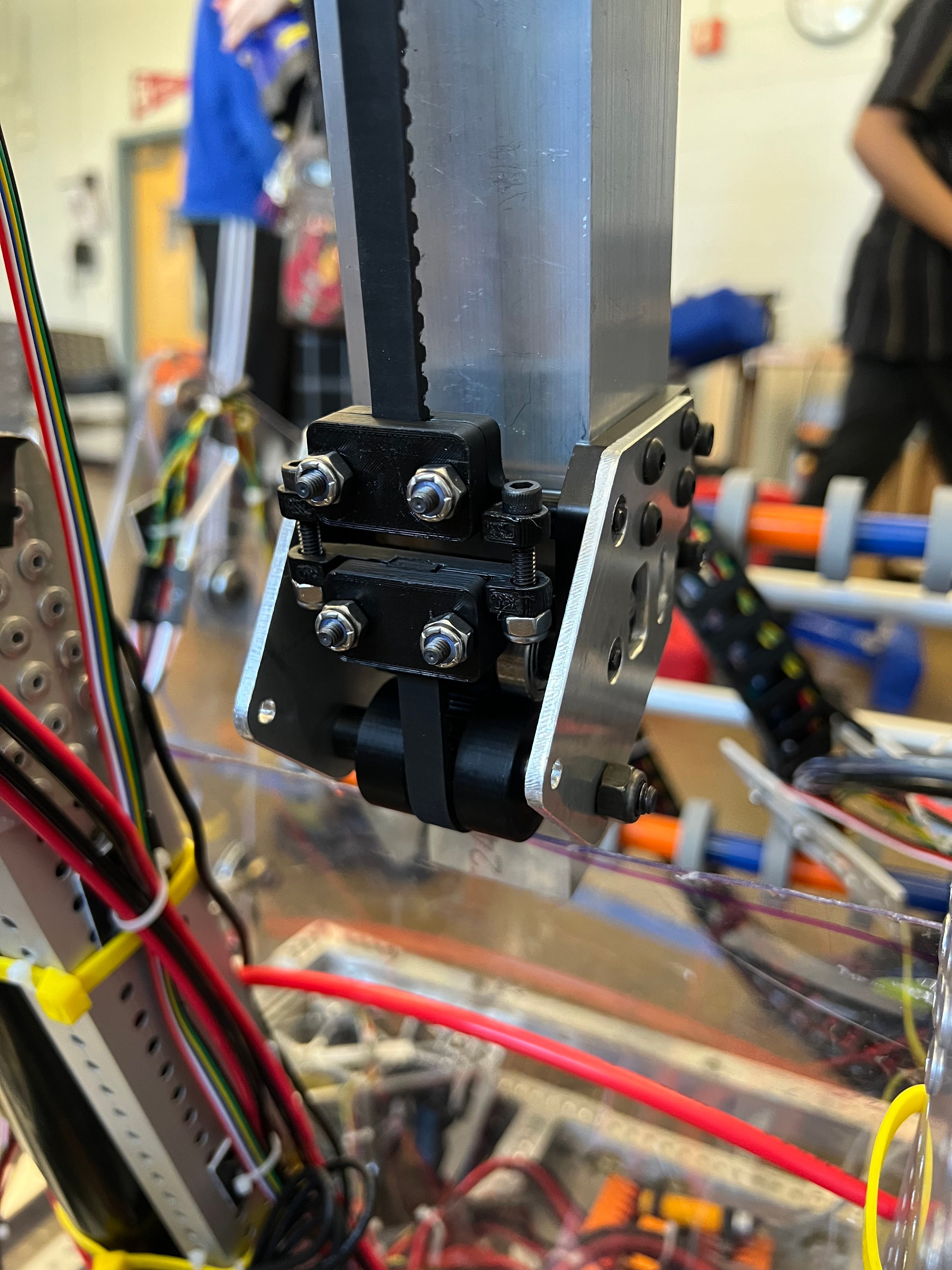

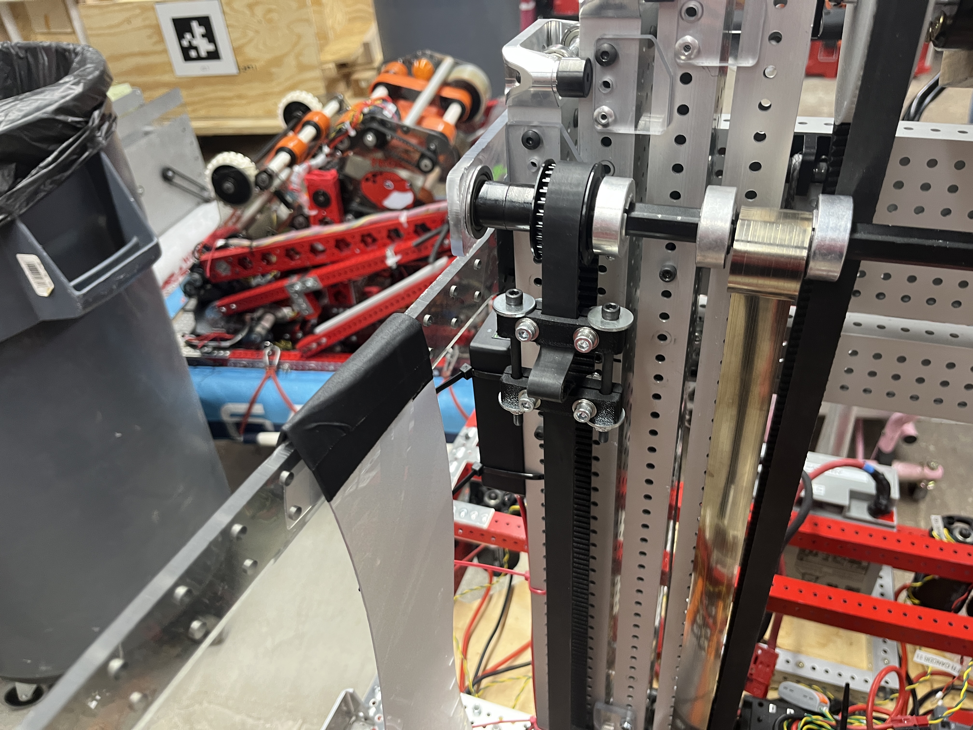

I’m actually a part of Last Anvil, but I’m happy to share some 3DP versions that my team (7525) used for their 2023 robot :slightly_smiling_face:
The first version is what we used, and they surprisingly stayed strong enough to last the whole season. I was worried it would break during comp, so there is a version 2 as well that is designed to be more robust. These were printed in PLA+ and are for HTD-5mm 9mm wide belts. I figured I would share the whole arm assembly so you can see the use-case for it.
