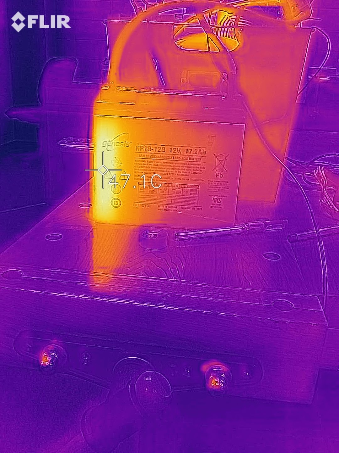

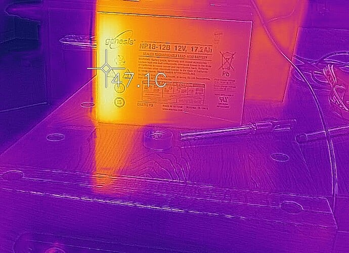

The OP mentioned that the batteries were hot as well. Were they uniformly hot, or was the heat concentrated in one area. As batteries age, they will eventually drop a cell. Under load that cell will be much hotter than the other cells.
Here is a thermal image of a battery that demonstrated a failed cell under testing this year.
