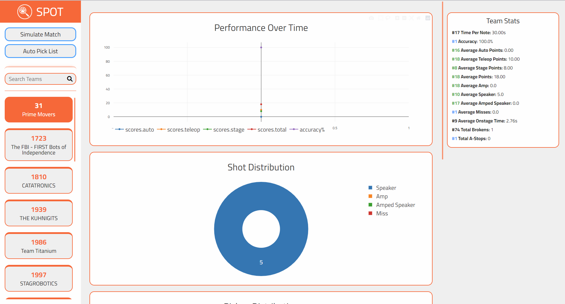

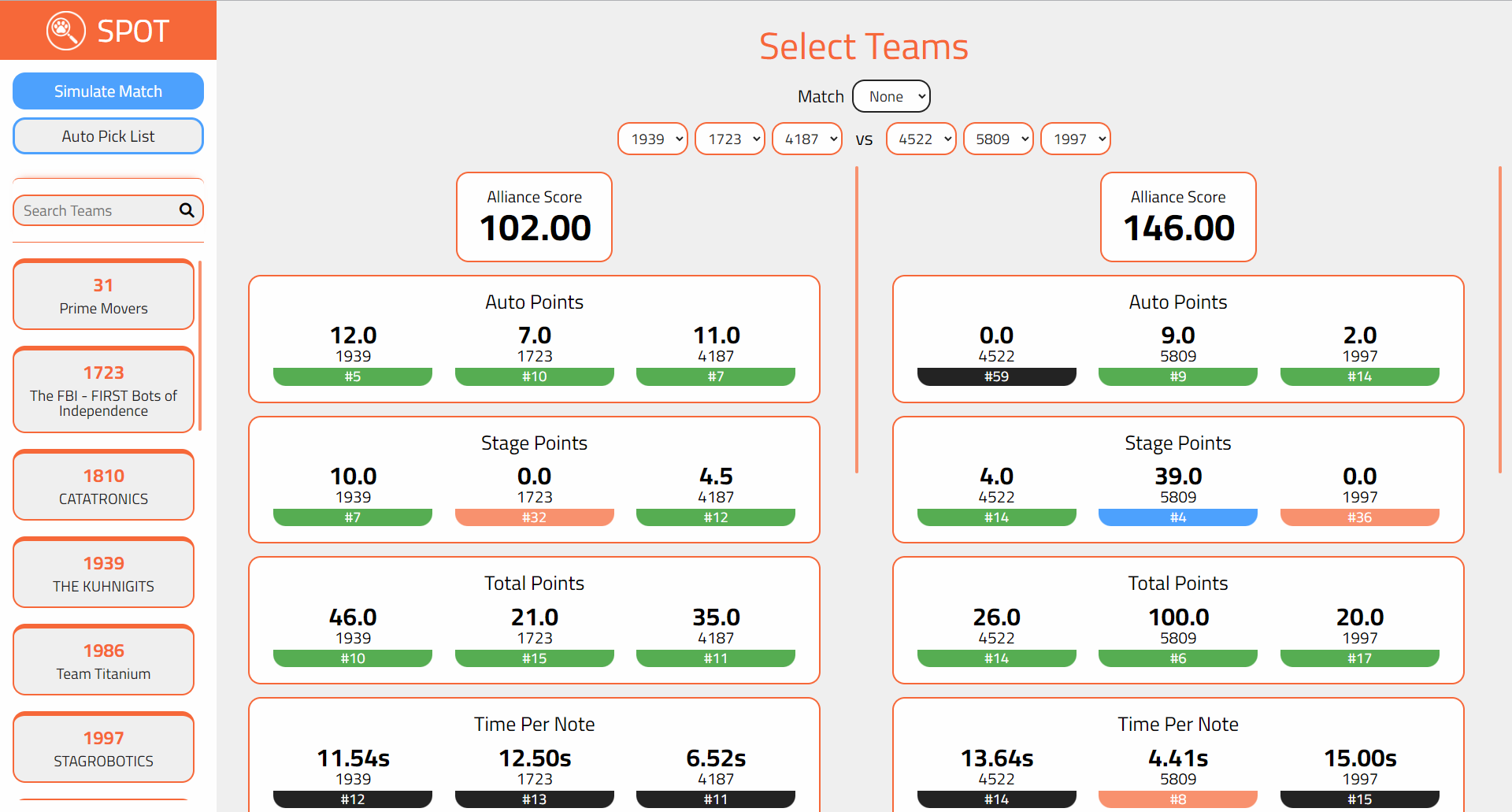

This looks very cool. I have a few questions:

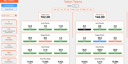

  1. In the analysis demo, it seems that for some reason in a match simulator, Q3 for example, somehow there are 75 stage points in the prediction.
  2. Why are harmony and amplified speaker shots taken into account? They don’t mean much on their own
  3. How would I go about adding a candle bar graph, or a radar chart?
  4. Is there a way to assign specific teams to specific scouters?
  5. Does the timer take into account the disabled time between auto and teleop?
  6. I’ve noticed a weird behavior with the timer, after starting a match, undoing, and starting again, and pressing the match time again, something odd is happening.

The 75 stage points from the demo data were caused by a bug within our SPOT code. We’re fixing that error and will release the patched version in an upcoming release.
We believe that statistics such as harmony and amplified speaker shots can be useful in a bigger-picture context. For example, it helps to see a team’s tendency to shoot with amplified shots vs. non-amplified shots. Furthermore, these stats will help us with generating more accurate match predictions.
In the future, there will be added support for different types of graphs. If you would like to do so, you can fork our current repository and add implementation for your analysis modules (e.g., candle bar graphs and radar charts). We store modules for our graphs within src → analysis → modules.
There’s not yet a supported feature for assigning scouters to specific robots, although it is currently in our backlog.
As of right now, the timer does not account for the disabled time between auto and teleop, though this problem will be fixed in our next release.
We are currently resolving some bugs with the undo button and others on our repository’s issues page. Please be on the lookout for our next couple of releases!

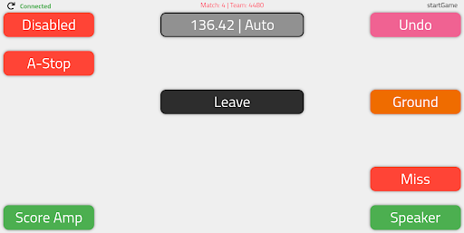

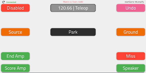

I like how simple your interface is because you don’t show any counters or timing values to the user. It is only buttons.
The downside is that scouters can’t correct mistakes. What is your advice to a scouter if they know they pressed a wrong button? Should they not submit the match data?
In the corner of each of SPOT’s screens is an undo button, which can undo any other action in the program. After undoing the action, click the correct action to replace it. As long as the scouter notices the mistake, the undo button allows them to correct it in the moment. I hope this answers your question.

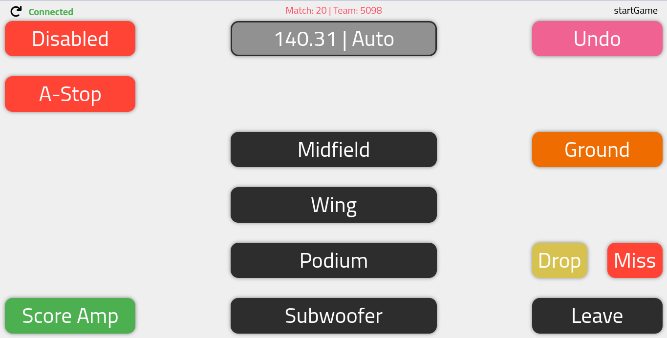

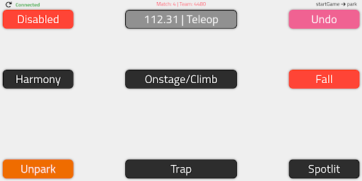

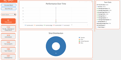

We are glad to see SPOT getting so much interest. We would like to share some screenshots of SPOT’s User Interface for easy reference without going to the demo website:
Scouter View 1
Scouter View 2
Scouter View 3

Hello everyone! We are excited to announce that we have finished making changes to SPOT for the 2024 season. Listed below are some new changes and a slide deck with updated instructions.
  • We updated the auto and teleop button layouts to mark the locations for speaker shots. We also added a drop note button.
    Each of the 4 buttons in the middle corresponds to a location on the field. If a note is shot into the speaker, then the scouter will select the respective location where the shot took place.

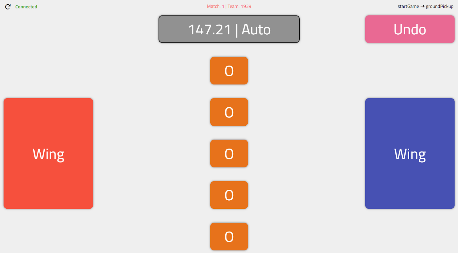

  • We also added a new layer to track specific locations of auto pickups, which is accessible from the auto Ground button.
    The orange buttons in the middle correspond to a note. We have two layers, one for scouters viewing the field from the side closest to the amp, and the other corresponding to scouters closest to the source side. Teams can edit which layer the scouter sees from match-scouting.json.
